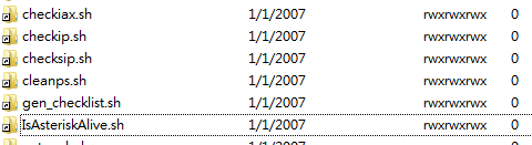

角色你睇一下你的/etc/下面有冇IsAsteriskAlive.sh  這個文件?
作者: 角色    時間: 2010-7-14 18:41
根据你给我的信息,可以说明ATCOM的firmware还没有做好。

本帖最後由 角色 於 2010-7-20 07:06 編輯
现在根据lttliang的IsAsteriskAlive.sh (放在/persistent/etc),我改良一下
  1. #!/bin/sh
  2. while [ 1 ]
  3. do
  4. IsAlive=`pidof asterisk`
  5. if [[ -z "$IsAlive" ]] ; then
  6. echo "Asterisk die at `date`" >> perisistent/tmp/dielog
  7.    reboot
  8. fi
  9. sleep 60
  10. done
放在/etc/init.d/asterisk

本帖最後由 bubblestar 於 2010-7-20 11:00 編輯
回復  ckleea
Thank CK for providing info about the verion log of IP01. However, they said that the ...
角色 發表於 2010-7-20 07:14
The file IsAsteriskAlive.sh routine is always there properly when I installed the firmware.  I don't know why you said you don't have it after installation.  Maybe there is some problem when updating the firmware.
圖片附件: 2010-07-20_105936.png (2010-7-20 11:00, 3.27 KB) / 下載次數 742
http://www.telecom-cafe.com/forum/attachment.php?aid=109&k=c8fddf85ab6e6992219f5d305afbec9f&t=1790656584&sid=geNIij

Build: 2010-6-9
    * Add script to detect if asterisk is alive. And start asterisk if it dies, script are only take effect after reset to factory default. If you want stop the asterisk for debug purpose. Please kill the IsAsteriskAlive process otherwise the Asterisk will start within 1 minutes after you stop it.
    * Fix the Ip01 fxo silent issue which introduce in last update.
另外,它們有兩個firmware 版本,正常應該是用 MD5 這一個的,原因如下:
There are two kinds of firmware:
Ext2 file:
the file is requested when upgrade from BAPS base firmware to Astfin2 base firmware. If your IPxx use the BAPS base firmware (old release model) and want to upgrade the Astfin2 base firmware, you use the ext2 file and upgrade via the RS232 port.
md5 file:
if you already use the Astfin2 firmware, you can upgrade the firmware via the GUI. More info about how to upgrade please refer the user manual. How to check if the device is BAPS base or ASTFIN2 base? the BAPS base firmware support ipkg command in the OS and Astfin2 firmware doesn’t support. You can use SSH to access to the firmware and run “ipkg update” to check if the ipkg is supported.
The default firmware shipped by ATCOM is Astfin2 structure firmware.
作者: bubblestar    時間: 2010-7-20 12:19

剛再UPGRADE至0.3.8,一切順利。IsAsteriskAlive.sh 一樣係度。連RESTORE ALL CONFIG/NETWORK/PERSONAL SETTING 過程二十分鐘左右。
作者: 角色    時間: 2010-7-20 14:56
IsAsteriskAlive.sh是在/etc/rc.d/S99local里被call的。

restart 很多次asterisk progress后就reboot整个IP-01,所以看来现在的firmware都是有问题的。
作者: 角色    時間: 2010-7-31 07:01
我的IP-01终于死掉了!!!看来我要用第二套方案,就是有问题就reboot。
作者: 角色    時間: 2010-7-31 07:17
第二套方案就是把IsAsteriskAlive.sh里/etc/init.d/asterisk start改为reboot。
看看效果怎样。
