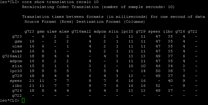

AsteriskNOW 1.7 option 4 gives you the most convenient way to start up an asterisk server with the necessary libraries and modules loaded. It shall save you a lot time to compile and make them. For instance, the codecs G729 and G723 can be implemented by copying the codec DIRECTLY to the /usr/lib/asterisk/module directory.
iLBC can also be directly copied to /usr/lib/asterisk/module directory too. However, the speex.so could not. Investigation has been made to see if there any means to fix it.
作者: 角色    時間: 2010-8-5 02:12
本帖最後由 角色 於 2010-8-5 02:13 編輯
Finally the required codecs including g729, g723, speex, iLBC are successfully installed.
It is seen from above figure, it shows the g729 performs every well.
圖片附件: 0009.png (2010-8-5 02:11, 8.4 KB) / 下載次數 1749
