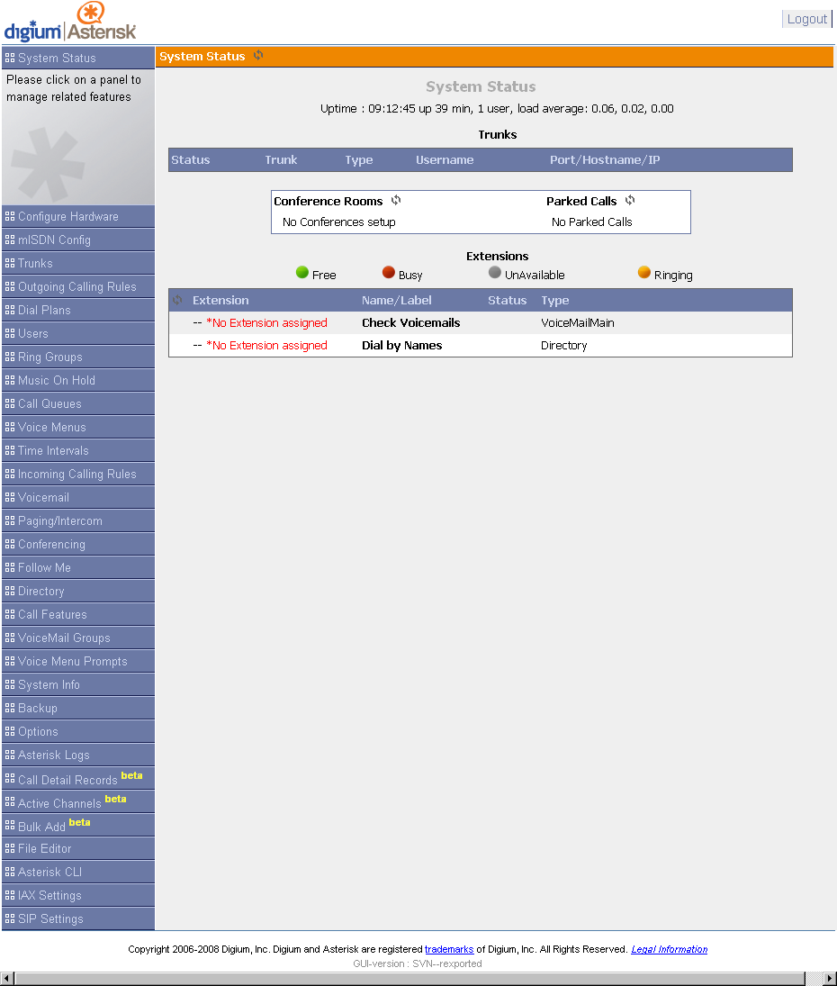

Asterisk-GUI 2.0的界面:
圖片附件: 0005.png (2010-8-3 09:17, 53.56 KB) / 下載次數 1698
http://www.telecom-cafe.com/forum/attachment.php?aid=120&k=808cf1b9813ed3b99651f6e8273a6958&t=1790633402&sid=X2pS4X

怎样才能有Digium Asterisk-GUI 2.0?
最简单的方法是去www.asterisk.org下载它的AsteriskNOW 1.7.ISO。安装时选择Option 4:Asterisk 1.4 + Asterisk-GUI。
下载网址:http://www.asterisk.org/downloads
安装过程中,在sendmail 和打后一个文件要等很久,这是我们还没有设好network card的原因。
进入root prompt时,
1)输入 system-config-network,更改network参数后,  /etc/init.d/network restart
2)输入yum -y update (如果没有这一句,整个系统根本不能工作)
3)reboot
4)edit /etc/asterisk/http.conf as follows:
enabled = yes (remove semicolon)
enablestatic = yes (remove semicolon)
bindaddr = 0.0.0.0 (change from 127.0.0.1 to 0.0.0.0 to allow all IP)
prefix = asterisk (you have to put this for Asterisk 1.6)
5) edit /etc/asterisk/manager.conf as follows:
eanbled = yes
webenabled = yes
#add the following lines
[admin]
secret = test
read = system,call,log,verbose,command,agent,user,config
write = system,call,log,verbose,command,agent,user,config
GUI的Login name = admin, password(asterisk 叫 secret) = test
6) execute /etc/init.d/asterisk restart
7) Using an brower with the URL =  http://<your_asterisk_server_IP_address>:8088/asterisk/static/config/index.html
那么你就可以看到Asterisk-GUI的界面。
8) 输入 username = admin, password = test, 按login,那么你就可以进入Digium的Asterisk-GUI界面了。
