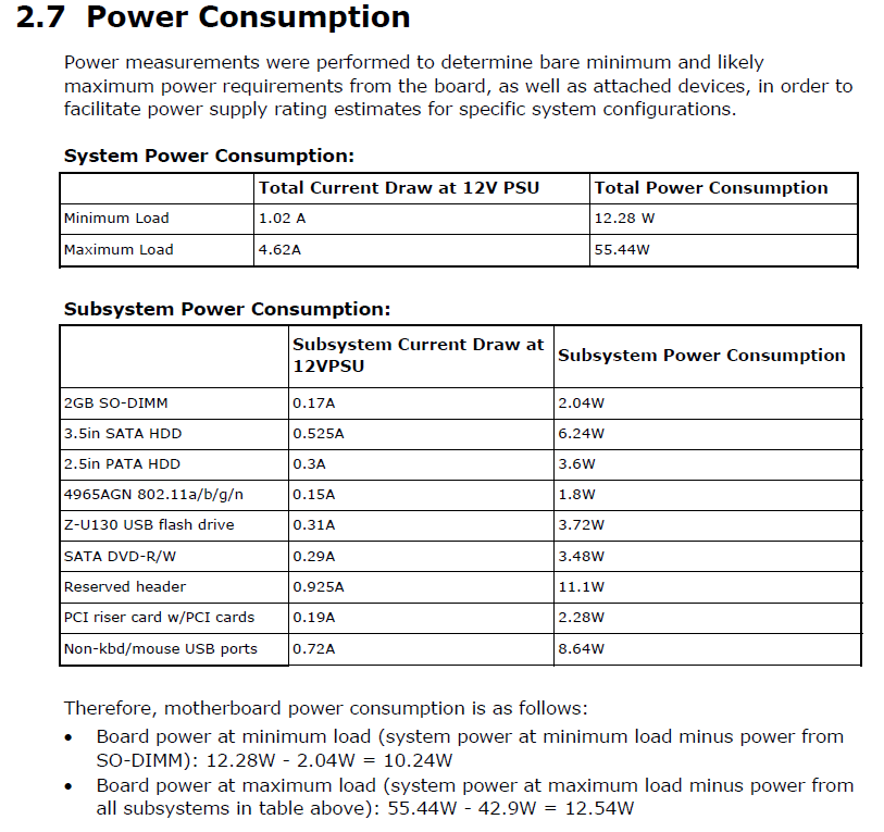

Intel  D945GSEJT ATOM N270 System Power Consumption Estimation:
圖片附件: 0032.png (2010-9-5 07:45, 85.01 KB) / 下載次數 2773
http://www.telecom-cafe.com/forum/attachment.php?aid=183&k=40e74a9a8cddcbe7caf1ff60bb1510d0&t=1790649647&sid=bE6tTZ
