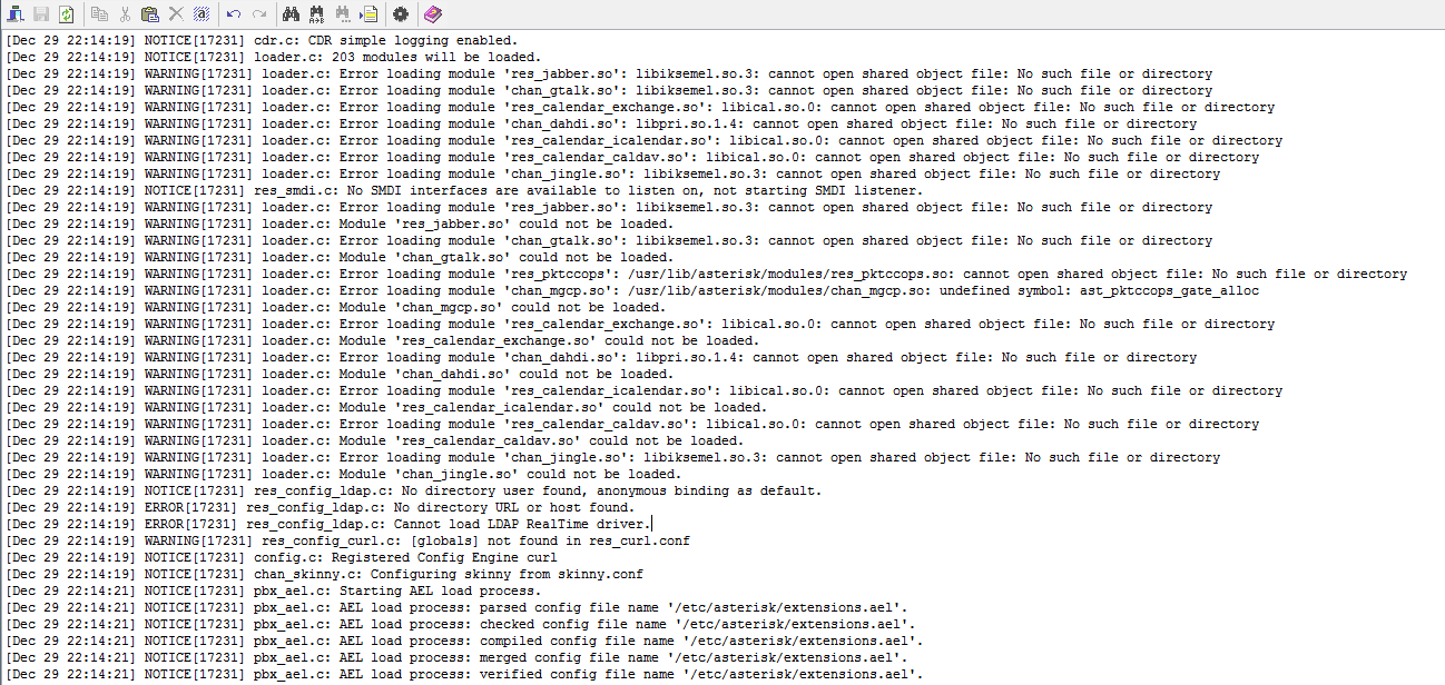

係呀,試咗幾個版本,Asterisk 1.8 仍然遇到不少問題。Asterisk 1.6 沒有用開,而Asterisk 1.4 最穩定,而且又有做Backup,只是未試過 64 bit 版本,都唔錯,暫時用住Asterisk 1.4 without GUI。想到辦法才再裝 Asterisk 1.8,因為係咁 install / uninstall 好傷SSD 嘛!
Asterisk 1.8 好奇怪,已跟足指示步驟安裝,WinSCP 也檢查過 res_jabber and chan_gtalk 全部係到。沒有error,但到咗boot 機之後,會出現如下。
圖片附件: Error.png (2010-12-30 17:02, 72.41 KB) / 下載次數 3398
http://www.telecom-cafe.com/forum/attachment.php?aid=379&k=bb32b689f6cad78b4632830ab536dbce&t=1790671233&sid=IVS7dI
作者: ckleea    時間: 2010-12-30 17:07
回復 13# bubblestar
Wrong version of library used. You encounter this problem when you upgrade your system too frequently. This is why many stable system do not bother any upgrade. Of course this is not for Microsoft windows based system!
作者: bubblestar    時間: 2010-12-30 17:24
I just install from scratch by compiling 1.8.1.1 directly instead of 1.8
Could you advise which version of library should be used.  Thanks.

作者: bubblestar    時間: 2010-12-31 11:25
回復 18# ckleea
Ha Ha !  I follow this link.
http://www.telecom-cafe.com/foru ... d=3184&pid=9647
作者: bubblestar    時間: 2010-12-31 11:30
回復 19# ckleea
Yes, I did.  But I don't think they are all installed in proper path.  Anyway, I WILL try 32 bits again until it succeeds.

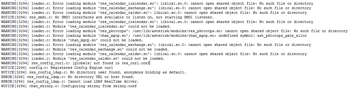

作者: bubblestar    時間: 2011-1-1 17:20
回復 20# ckleea
Following ckleea's recommended link and their method, I re-compiled Asterisk 1.8.1.1 again.  This time, the errors mesage of chan_gtalk and res_jabber are resolved as they disppear from the /var/log/asterisk/messages.    What a useful guideline!  Thanks.
However, there are still errors loading modules for the res_calendar_icalendar.so and related files.  I remember that ckleea C-Hing had said he had some problem on icalendar when compiled his Asterisk 1.8 some months earlier.  Is that the same problem as you?  Could you advise how it was resolved?  Thanks.
圖片附件: icalendar_error.png (2011-1-1 17:20, 29.77 KB) / 下載次數 2676
http://www.telecom-cafe.com/forum/attachment.php?aid=391&k=dc8bcfbb8dcd9db1c83f2eeb91e9bc1c&t=1790671233&sid=IVS7dI
作者: Qnewbie    時間: 2011-1-1 17:30
It seems that the libical.so.0 is missing or not on the proper directory.
作者: ckleea    時間: 2011-1-1 19:48
回復 23# bubblestar
    There are also some tricks. Get the neon-devel to install
