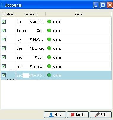

I found this client is quite good for us. It allows multiple SIP and IAX registrations.
http://www.yate.null.ro/pmwiki/index.php?n=Main.YateClient
It can be used as an alternate to Zoiper especially that if you don't want to pay.
