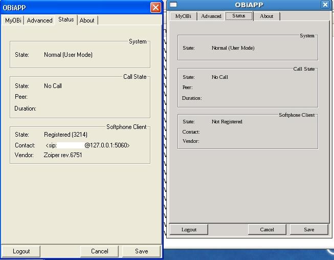

作者: ckleea    時間: 2011-3-4 07:17
Here is a post of connection status
In Linux/centos on the right side of the picture,
I use wine to run the PC desktop client and connected by Zoiper via another PC, the zoiper shows it is connected but the client's status shows no softclient connect.
On the left side, PC desktop client on a windows XP notebook, Zoiper connects and dial out well.
Conclusion: need a geninue linux client to make the asterisk connection work.

作者: bubblestar    時間: 2011-3-4 10:58
If you encounter problem that shows 404 route not found or circuit busy.  The possible reasons might be that of wrong number dialled or incompatible codecs used.
作者: ckleea    時間: 2011-3-4 12:55
回復 12# bubblestar
No, it is rather due to not  registered. I think there is problem in using the PC apps under Wine/Linux.
This is why I ask for a command line linux client.
