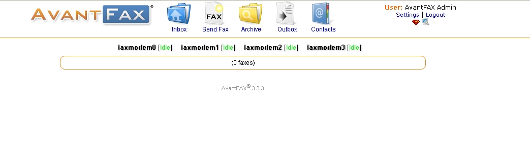

For frontend, try to install avantfax
http://www.avantfax.com/
Installation below
http://www.avantfax.com/install.php
圖片附件: screenshot.03-03-2011 22.30.01.jpg (2011-3-3 22:36, 71.99 KB) / 下載次數 4384
http://www.telecom-cafe.com/forum/attachment.php?aid=495&k=72e2c0df9d292a14e39ec6d3e6e23f81&t=1790772453&sid=T0CV02

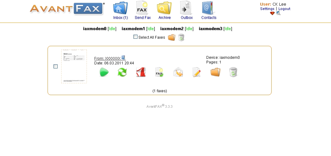

Some more screenshot using Avantfax.
I use HKBN 2b account to fax in and out. 100% software based
Avantfax allows me to send / receive faxes via web gui. Then forward via email.
I have installed an OCR for fax but not tested.
圖片附件: screenshot.11-03-2011 06.47.23.jpg (2011-3-11 06:55, 106.97 KB) / 下載次數 5349
http://www.telecom-cafe.com/forum/attachment.php?aid=521&k=7f4df3e929de22f0cdeb4d33fbff1886&t=1790772453&sid=T0CV02
