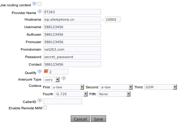

I set up the account according to post 5 in this thread and the following:
圖片附件: [ET263] ET263.png (2011-3-25 16:47, 32.03 KB) / 下載次數 2098
http://www.telecom-cafe.com/forum/attachment.php?aid=575&k=f9234904a6734e7542df959db4235ca0&t=1790701986&sid=0lH9gv
作者: 角色    時間: 2011-3-25 16:52
How was the results?
作者: Qnewbie    時間: 2011-3-25 16:56
Modify the outbound rule with Dial:
  1. exten=_0086x.,1,Dial(SIP/588xxxxxx/0${EXTEN:4},,r)
  2. exten=_0086x.,n,Hangup()
Got 503, "Service unavailable" back
