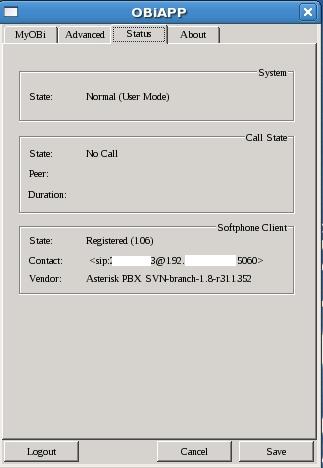

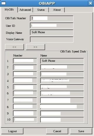

6. use wine to install obiapp. Using the default program position should be ok

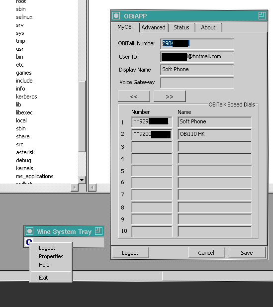

7. use wine to run obiapp the first time to enter your login information.
8. when login, you can see your status in ObiTalk

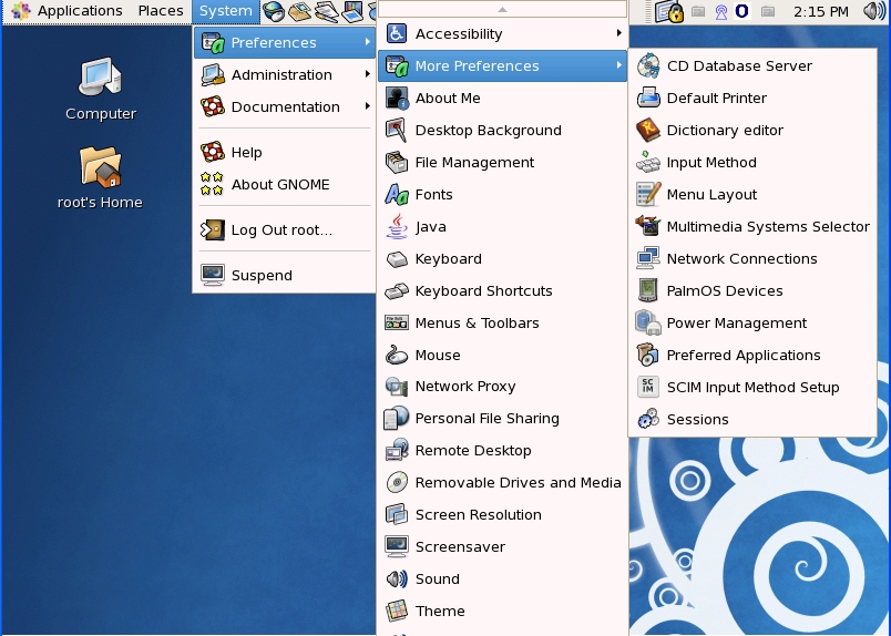

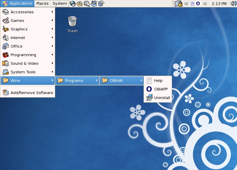

10. to autostart obiapps, linux x-windows, wine.
use vnc to connect to your root gnome.
locate the session from here

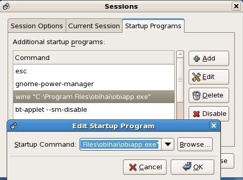

add the following to the startup program
wine "C:\program files\obihai\obiapp.exe"
Now you should have your obiapp running automatically after your linux server boots up.
Always check with asterisk to see if you are registered.

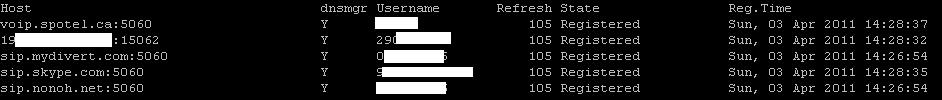

sip show registry as below
sip show peers as below
Please note that while your asterisk registers the Obiapp soft client as the usual lan IP, but in the outgoing context you need to have another IP address. I.e. what I described before to use webmin to create a virtual network interface for your linux server.

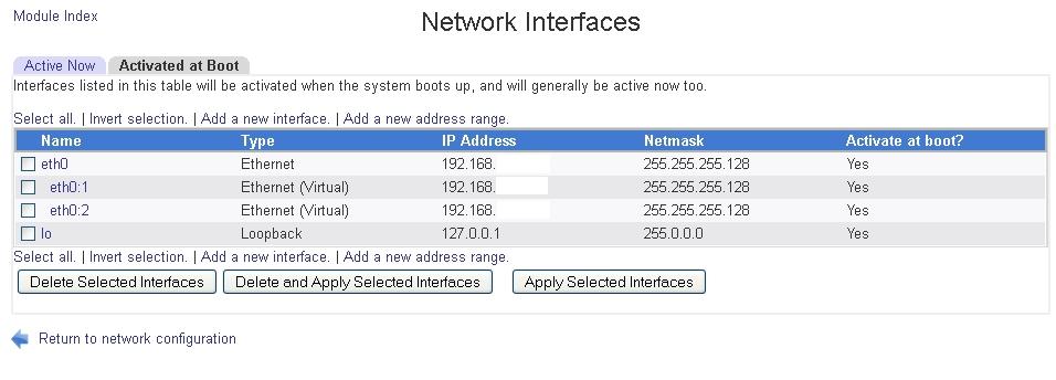

Remark: in webmin, you need to create as below
圖片附件: screenshot.03-04-2011 14.28.38.jpg (2011-4-3 14:40, 23.16 KB) / 下載次數 3332

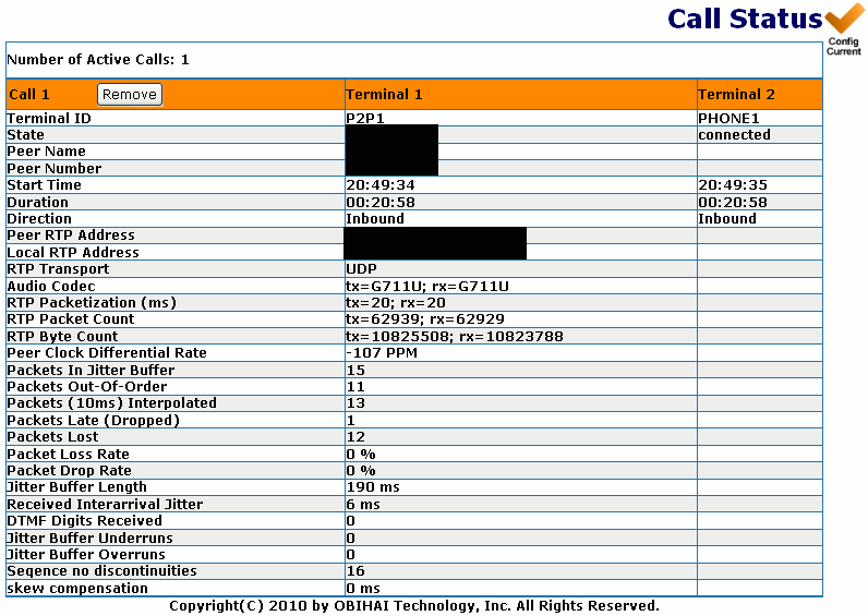

作者: 角色    時間: 2011-4-4 21:36
I just asked bubblestar CHing for calling me to evalue performance of the Linux + OBiAPP by calling my OBi110. The performance was very good that I did not find any difference between the OBi110 and Linux + OBiAPP. The following figure shows the call status of my OBi110.

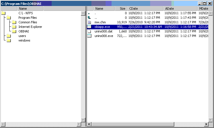

现在用wine explorer,安装到OBiapp.exe,

After you have installed the OBiApp.exe, then there is a pop-up window which asks you to the OBiHai login e-mail address and password. Right click the small window, a small window comes out. You select the "Properties", a very big window comes out.
