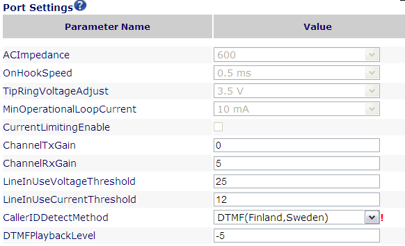

Macau澳门 的 Caller ID setting in Line setting:
CallerIDDetectMethod = DTMF (finland,..) or DTMF (denmark)
can detect Caller ID
最好的是 Caller ID setting in Phone setting:
CallerIDMethod = FSK
我的美国买的电话(FSK) 能显示澳门 的 Caller id

作者: leftright    時間: 2011-4-5 01:24
看起来Macou的CID和香港,大陆的不太一样...
Default CID setting on PHONE port is FSK(bellcore), so I don't think you need to change that, correct?
只是想确认一下,for Macou CID, 设置应该是:
Physical interface --> line port --> CallerIDDetectMethod = DTMF (finland,..) or DTMF (denmark)
作者: yiucsw    時間: 2011-4-5 02:05
Do not find any different for DTMF(Finland) or DTMF(Denmark) so  use Finland.
Currently the Callerid successfully decoded.
no time for further test.
圖片附件: macauCID.PNG (2011-4-5 02:02, 17.18 KB) / 下載次數 2087
http://www.telecom-cafe.com/forum/attachment.php?aid=656&k=e09a540f5fd7b4619aac50b15b452640&t=1790646514&sid=OOre00
圖片附件: macauCID.PNG (2011-4-5 02:03, 17.18 KB) / 下載次數 1975
http://www.telecom-cafe.com/forum/attachment.php?aid=657&k=cbd397587b1a5dbba7369a877c0f8db6&t=1790646514&sid=OOre00

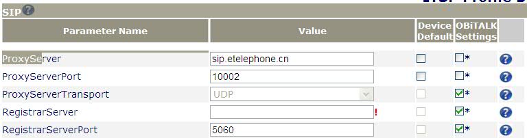

et263 register error
当注册 ET263 有 register error, 最终发现Register Server 是不能有 “sip.etelephone.cn",真无语。
圖片附件: obi-et263.PNG (2011-4-6 12:33, 25.93 KB) / 下載次數 1323
http://www.telecom-cafe.com/forum/attachment.php?aid=665&k=7251f98787568ab674ccf634c0c3a26b&t=1790646514&sid=OOre00

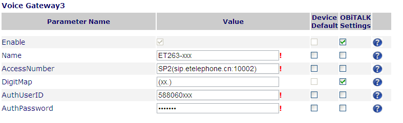

来不及等角色的 ET263 的 Sample configuration:
以下是我的配置:
phone port : DigitMap
([1-9]x?*(Mpli)|[1-9]|[1-9][0-9]|911|**0|***|#|**1(Msp1)|**2(Msp2)|**3(Mvg3)|**4(Mvg4)|**6(Mvg6)|**7(Mvg7)|**8(Mli)|**9(Mpp)|(Mpli))
PHone port : OutboundCallRoute
{([1-9]x?*(Mpli)):pp},{(<#:>|911):li},{**0:aa},{***:aa2},{(<**1:>(Msp1)):sp1},{(<**2:>(Msp2)):sp2},{(<**3:>(Mvg3)):vg3},{(<**4:>(Mvg4)):vg4}, {(<**6:>(Mvg6)):vg6},{(<**7:>(Mvg7)):vg7},{(<**8:>(Mli)):li},{(<**9:>(Mpp)):pp},{(Mpli):pli}
不知道对不对。先用 **3013XXXXXXXXX 打出。
圖片附件: etGW.png (2011-4-7 23:44, 20.28 KB) / 下載次數 1367
http://www.telecom-cafe.com/forum/attachment.php?aid=671&k=024efb1f5d5515216fae247031a1fa3d&t=1790646514&sid=OOre00
作者: 角色    時間: 2011-4-8 00:12
能否打出呢?
作者: yiucsw    時間: 2011-4-8 02:28
可以,打出没有问题
作者: 角色    時間: 2011-4-10 12:31
