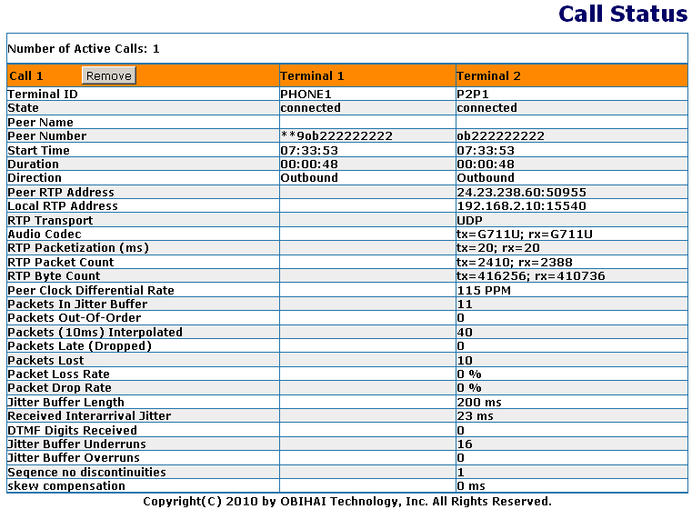

刚刚下载了最新的firmware 1.2.1 (2103),然后进行Echo Test,效果不错:
之前的firmware,到自己说的时候,echo test就经常听不到自己的说话。

Just gave a Obi call to a member in Hong Kong. He replied that the voice quality is the same as last night and he was not able to find the difference.
That is to say, the OBi firmware release 1.2.1 (2103) has already fixed the choppy voice coming from China to Hong Kong.

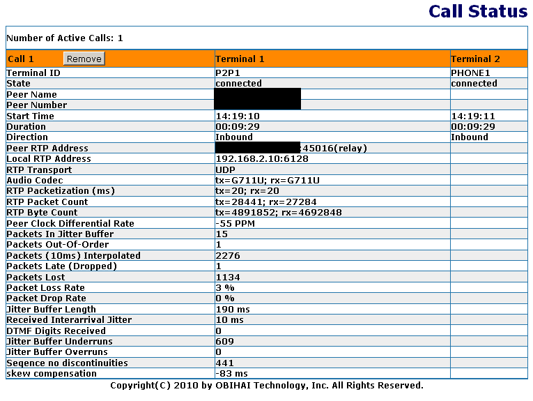

This time another member called my Shenzhen OBi110 device, both could hear the other very clearly. The call status given below is for your interest and reference.

刚刚我也测试了一下,效果的确改良了不少,结果也相差不多,就不另发了

Echo Test和美国800热线:)
以前丢包都是30%起的,现在基本维持在3%左右,一个数量级的差别太明显了
