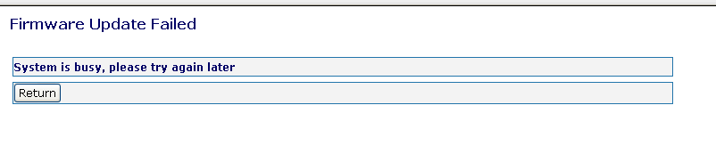

作者: ckleea    時間: 2011-5-10 15:09
I can't make the upgrade right now. From Obi Expert, not able to upgrade. From network interface, it says system is busy.
My Obi is amber light.

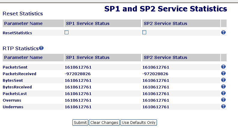

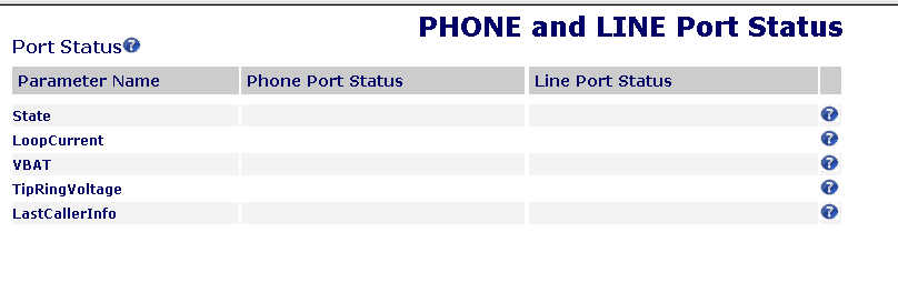

作者: ckleea    時間: 2011-5-10 20:31
My problems are like these

作者: bubblestar    時間: 2011-5-10 20:45
It seems OBi110 is being drown by floods of packets.  If this phenomenon persists a period of unreasonable time, I suggest unplug or reset the device(using a pin to press the tiny hole at the bottom of OBi110).
Don't know if it will work or it will brick the device.  It depends on how brave you are.
作者: ckleea    時間: 2011-5-10 22:14
回復 13# bubblestar
I finally make it work again.
Factory reset, firmware update, reload the configuration.
Problem likely due to an interruption during remote update /download but I have not done any remote update.

作者: ckleea    時間: 2011-5-11 05:51
回復 18# daibaan
    In my case, my Obi110 just did not generate any dial tone. Except I could access the interface and changed some settings, all the telephone functions did not work until I made a full factory reset.

回復 21# 角色
At the beginning, after I read the update announcement, I logined into my account and found the update notification. I click on this "!", it brought me to the announcement page. I checked update could be done locally. It popped up the message that system was busy.
Many attempts failed Reboot many times.
Until finally, I tried on factory reset. I am able to update the firmware locally.
What I encountered within that few hours were
1. Obi110 was offline
2. no connection tone when the phone was plugged in.
3. the status screens I posted up early
4. I could till enter the box to make some changes, except could not reset the box, reset satstistics.
Very strange behaviours.
