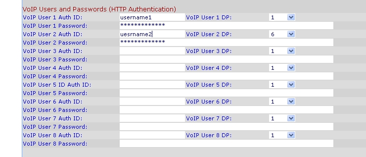

作者: ckleea    時間: 2011-6-3 13:34
回復 4# 浮雲1965
請看這頁
http://www.telecom-cafe.com/foru ... light=http%2Bdigest
我在generic asterisk 需要 set
sip.conf
extensions.conf
SPA3000 在PSTN TAB set
圖片附件: screenshot.1.jpg (2011-6-3 13:34, 131.88 KB) / 下載次數 2709
http://www.telecom-cafe.com/forum/attachment.php?aid=764&k=94be842152692c765c98e41cf74d63e9&t=1790652540&sid=QzTSV8

作者: ckleea    時間: 2011-6-3 22:04
回復 11# 浮雲1965
Add the following to sip
[pstn-spa3k-d1]
type = peer
secret = password
username = username
host = 192.168.xxx.xxx
fromuser = username
port = 5061
dtmfmode = rfc2833
qualify = yes
nat = yes
context = default
disallow = all
allow = g729
allow = ulaw
allow = alaw
Add the following to your extensions.conf
[CallingRule_viaspa3000]
exten => _89.,2,DIAL(SIP/pstn-spa3k-d1/${EXTEN:2})
username and password match your entry in the PSTN TAB of SPA3000
