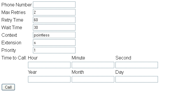

After some investigation, I found a script to do click to call. It is not difficult but works.
However, I notice that there are few errors and problem
1. The callfile generated has some extra carriage return. In CLI it shows as warnings
2. I cannot dynamically assign channel to use . Therefore, either your handset is connected your asterisk as an extension or connected based on your location. The latter is really important because you may not have wifi for your VoIP during connection but you are using some local phone at somewhere in the world
3. Need definitely upgrade the existing IVR for more robust setup
4. You need a server to run the php script and local read write to pass the callfile to asterisk server. In IP01, it means you need to add lighttpd during compilation.

I m by no mean an expert in programmer so it is done by trial and error.
My present developing screen likes this

作者: ckleea    時間: 2011-6-16 17:59
回復 5# Qnewbie
Is it something you look forward to have?
作者: Qnewbie    時間: 2011-6-16 18:05
No exactly the callback I am looking for.
Both legs should be assigned by the web. One leg is checked by asterisk, or with auth. code.
作者: alang    時間: 2011-6-16 18:16
可能是英文我比較看不懂,關於第二點,如果使用 callback + DISA, 那還需要開發 script for dynamic route?
作者: ckleea    時間: 2011-6-16 20:02
回復 8# Qnewbie
You mean to have both numbers set in the web. Asterisk deals with connection for both sides?
作者: Qnewbie    時間: 2011-6-16 20:18
回復 10# ckleea
    Yes!
Most click2call act as one leg for outbound call, the other leg is internal number.
作者: ckleea    時間: 2011-6-16 20:22
回復 11# Qnewbie
    Then it needs manual programming.
作者: Qnewbie    時間: 2011-6-16 20:30
Yes, programming is needed.
It should not be considered as web click2call, should be web callback.
作者: ckleea    時間: 2011-6-16 20:58

SO you are looking for a solution like this
http://skysiptel.com/wp/?page_id=53
作者: Qnewbie    時間: 2011-6-16 22:27
Yes, exactly!
