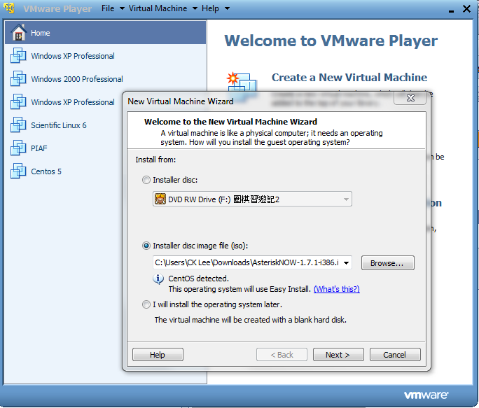

Since some members are unable to have a good installation, I would like to demonstrate how to install the centos base server, tools, and various libraries for the setup of asterisk 1.8.7
I use AsteriskNOW and VM for demonstration
AsteriskNOW can be obtained from here
http://www.asterisk.org/asterisknow/
AsteriskNOW is based on Centos 5.5
Asterisk source codes can be obtained from here
http://www.asterisk.org/downloads
However, if you wish to use centos 5.7, you can get it from http://www.centos.org
I do not recommend to use rpm packages of asterisk as it may not be flexible enough for the installation. Source code compilation allows most customizations.
作者: ckleea    時間: 2011-9-18 15:28
本帖最後由 ckleea 於 2011-9-18 15:44 編輯

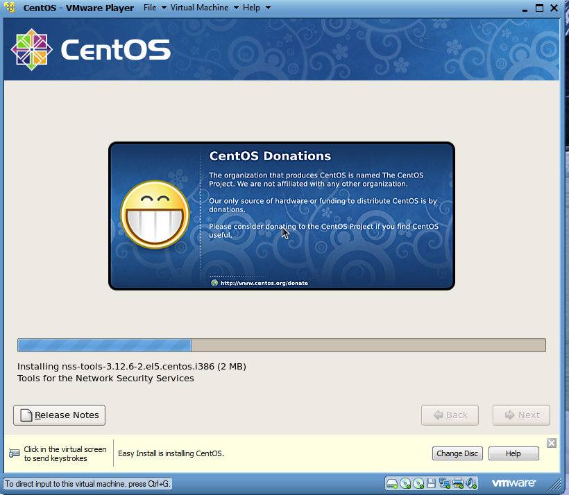

Using VMplayer to install a virtual machine for Centos is very easy and fast
Just answer a few question on DVD location and default user name and password. No need for disk partitioning and concern on the grub boot loader installation location
However, you can see I have installed just a few libraries that are not enough for asterisk
I then upgrade to Centos 5.7 by typing "yum update"
After reboot, you are in Centos 5.7

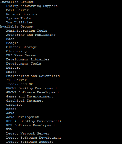

Next command is
yum groupinstall "Administration Tools" "Development Tools"  "MySQL Database" "Server Configuration Tools" "Web Server"
圖片附件: screenshot.2.png (2011-9-18 15:31, 49.23 KB) / 下載次數 2177

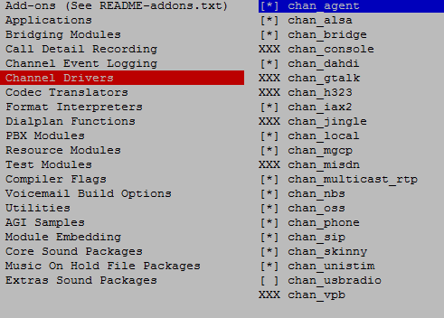

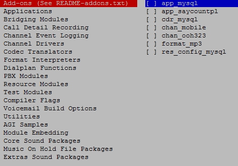

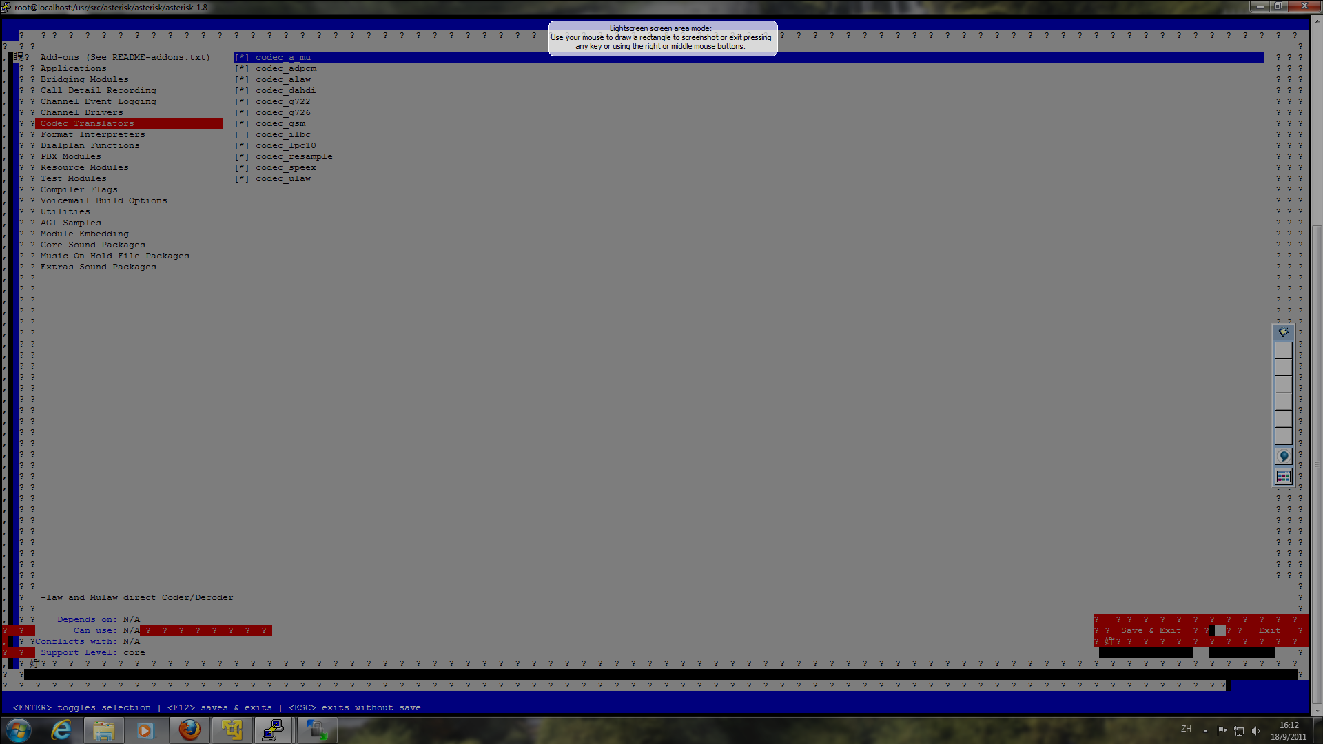

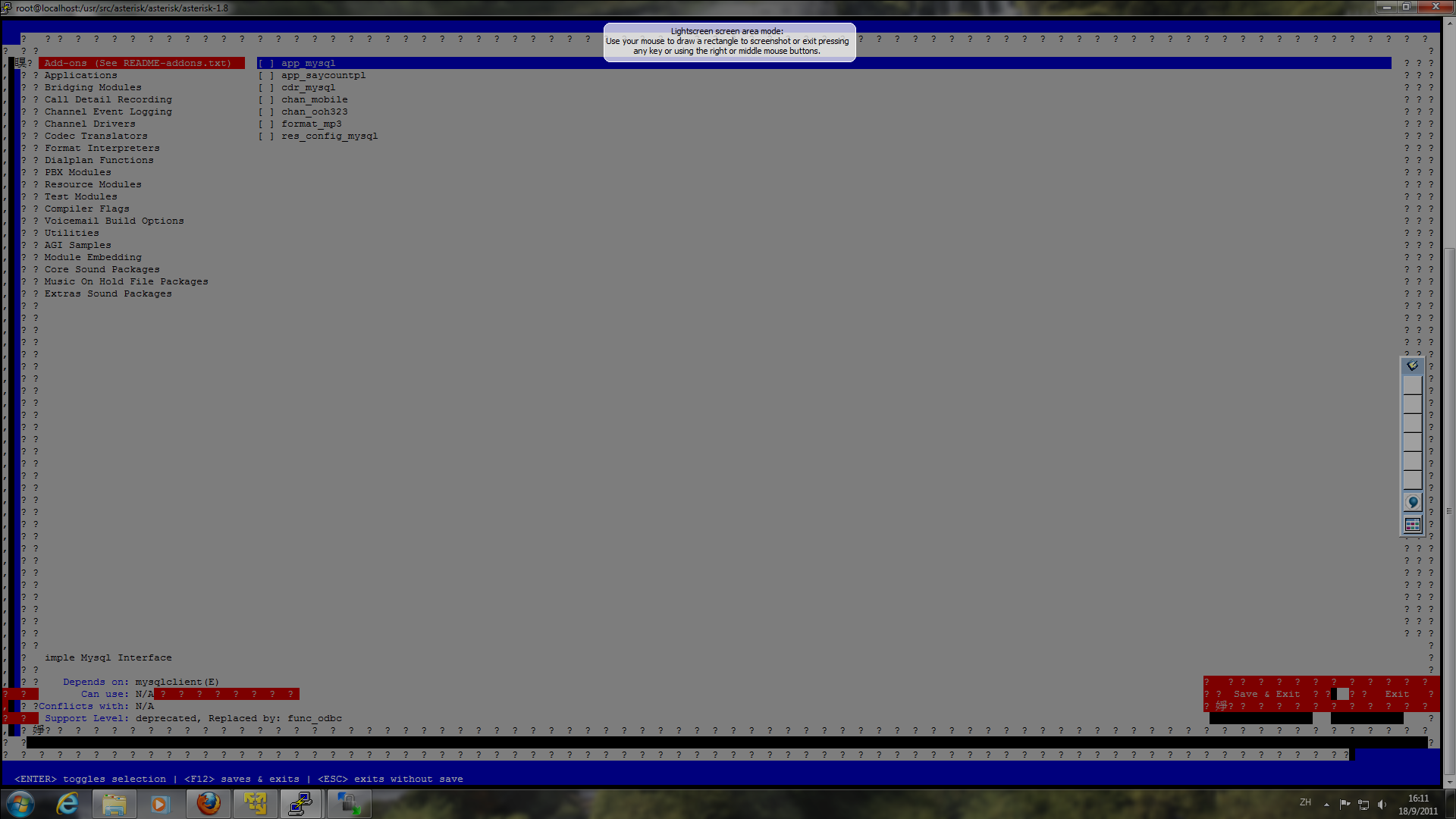

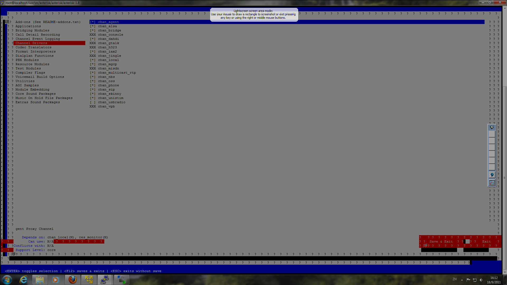

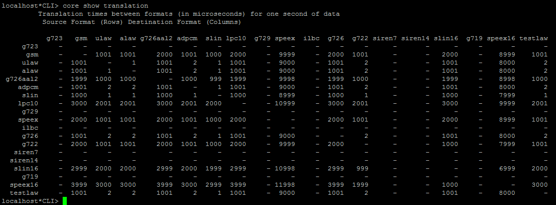

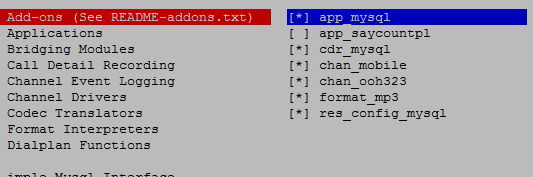

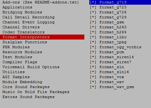

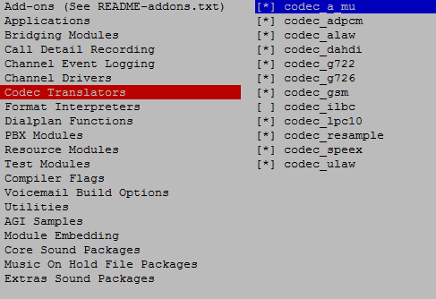

The asterisk menuconfig has the followings
Once finished, asterisk is already running.
附件: asterisk.zip (2011-9-18 16:09, 1.79 KB) / 下載次數 2485

圖片附件: screenshot.1.png (2011-9-18 16:20, 149.92 KB) / 下載次數 2284
http://www.telecom-cafe.com/forum/attachment.php?aid=905&k=74ae3311c746b778d6d0202768358854&t=1790608764&sid=GbqU5B
圖片附件: screenshot.2.png (2011-9-18 16:20, 6.74 KB) / 下載次數 2084
http://www.telecom-cafe.com/forum/attachment.php?aid=906&k=73093b4a4bd25b313d1a890332f29d49&t=1790608764&sid=GbqU5B
圖片附件: screenshot.3.png (2011-9-18 16:20, 156.37 KB) / 下載次數 2239
http://www.telecom-cafe.com/forum/attachment.php?aid=907&k=758f1684a691020c78b9569d39dd067c&t=1790608764&sid=GbqU5B
圖片附件: screenshot.4.png (2011-9-18 16:20, 8.22 KB) / 下載次數 2143
http://www.telecom-cafe.com/forum/attachment.php?aid=908&k=1c01cdc39db108ae2911285cc5882d90&t=1790608764&sid=GbqU5B
圖片附件: screenshot.5.png (2011-9-18 16:20, 151.39 KB) / 下載次數 2065
http://www.telecom-cafe.com/forum/attachment.php?aid=909&k=1d7d72594ef40a40421364c6e5963bc0&t=1790608764&sid=GbqU5B
圖片附件: screenshot.6.png (2011-9-18 16:20, 7.17 KB) / 下載次數 2288
http://www.telecom-cafe.com/forum/attachment.php?aid=910&k=926ee45e43a8390964e4f82c6e7dd15f&t=1790608764&sid=GbqU5B
圖片附件: screenshot.7.png (2011-9-18 16:20, 154.22 KB) / 下載次數 2138
http://www.telecom-cafe.com/forum/attachment.php?aid=911&k=c523d406beda2b2b759270056593a73f&t=1790608764&sid=GbqU5B
圖片附件: screenshot.8.png (2011-9-18 16:20, 7.61 KB) / 下載次數 2148
http://www.telecom-cafe.com/forum/attachment.php?aid=912&k=ec5513e4bac2c3ec573acf5d7d29d731&t=1790608764&sid=GbqU5B

Next is add iLBC and allows GUI login
Also need a proper iptables for internal firewall and configure mysql to support the server operation.

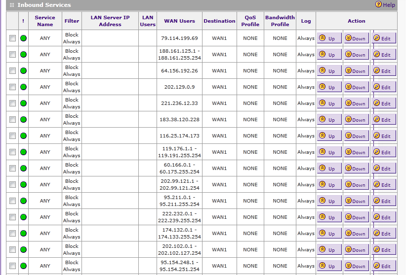

Also a table for the router ban addresses from hackers IP
圖片附件: screenshot.14.png (2011-9-18 17:53, 44.71 KB) / 下載次數 2159
http://www.telecom-cafe.com/forum/attachment.php?aid=914&k=2d51958f0dabb42d5bd6a1f0071a55c1&t=1790608764&sid=GbqU5B

install webmin from http://www.webmin.com
service webmin start
chkconfig webmin on
Go into the webmin to disable some of the unnecessary services
then fail2ban
  1. wget http://download.fedoraproject.org/pub/epel/5/i386/epel-release-5-4.noarch.rpm
  2. rpm -Uvh epel-release-5-4.noarch.rpm
  3. yum install fail2ban
  4. chkconfig fail2ban on
  5. service fail2ban start
Please note that this fail2ban package is linked to shorewall. Shorewall is a software firewall in linux, similar to iptables. It can conflicts with iptables. For better compatibility, please refer to http://www.fail2ban.org/wiki/index.php/Main_Page for installation and setup.
At this point, the basic asterisk server is now completed. Just edit the /etc/asterisk/sip.conf; extensions.conf; iax.conf; etc to get your ippbx running
圖片附件: screenshot.2.png (2011-9-18 18:14, 38.2 KB) / 下載次數 2171
