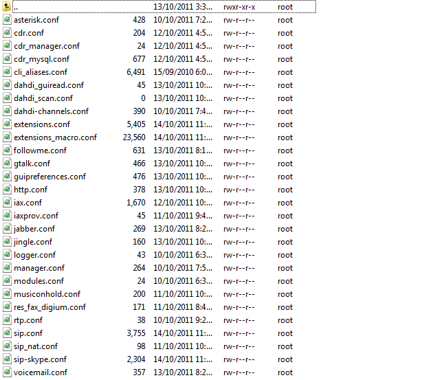

作者: ckleea    時間: 2011-10-15 00:13
I have moved all my macro into another conf file to make my extensions.conf nice and tidy.
I will follow this direction to clean up all the unnecessary and clumsy ordering of different labels.
作者: bubblestar    時間: 2011-10-15 00:22
That's a good idea and towards a right direction.  Our dialplan file size is getting larger and it is time to re-organize them in a systematic, manageable and easier way.
作者: ckleea    時間: 2011-10-15 07:18
This is the beginning.
I have defined two users for sip and iax connections using template approach. Few trunks that allow me to use resources. Other being setup in progress.
圖片附件: screenshot.15-10-2011 07.07.50.png (2011-10-15 07:15, 34.46 KB) / 下載次數 3096
http://www.telecom-cafe.com/forum/attachment.php?aid=968&k=31340d2e8c57657375268f7b43aeb6c3&t=1790602473&sid=IWccuV
