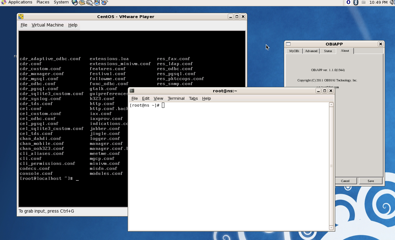

Initially I have just put a centos 6 VM in my linux server running under ATOM D525 CPU, 4GB Ram and Centos 5.7 32 bits and wish to see the performance. I use VMPlayer 4.0
I find the speed and performance of the old image is acceptable. Now I have an idea to set up a new Centos 6 - 32 bits, Asterisk 1.8x with GUI and MySQL backend, plus some other web service on a VM for testing first and then for second asterisk server.
Please see my thread below for information and progress. Look promising.
圖片附件: screenshot.08-10-2011 22.54.04.png (2011-10-8 23:02, 170.66 KB) / 下載次數 3154
http://www.telecom-cafe.com/forum/attachment.php?aid=942&k=89d97b872eee5209cb27922400319797&t=1790639720&sid=3IZq6j

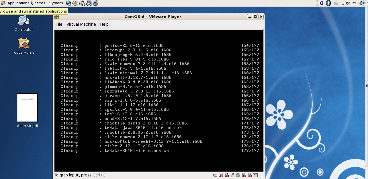

Once I complete, I issue an "yum update". the system is then getting the updates
圖片附件: screenshot.09-10-2011 15.09.09.png (2011-10-9 15:16, 250.04 KB) / 下載次數 2574
http://www.telecom-cafe.com/forum/attachment.php?aid=952&k=c52c9b4dde0acb0b982cb060b0cc4d82&t=1790639720&sid=3IZq6j

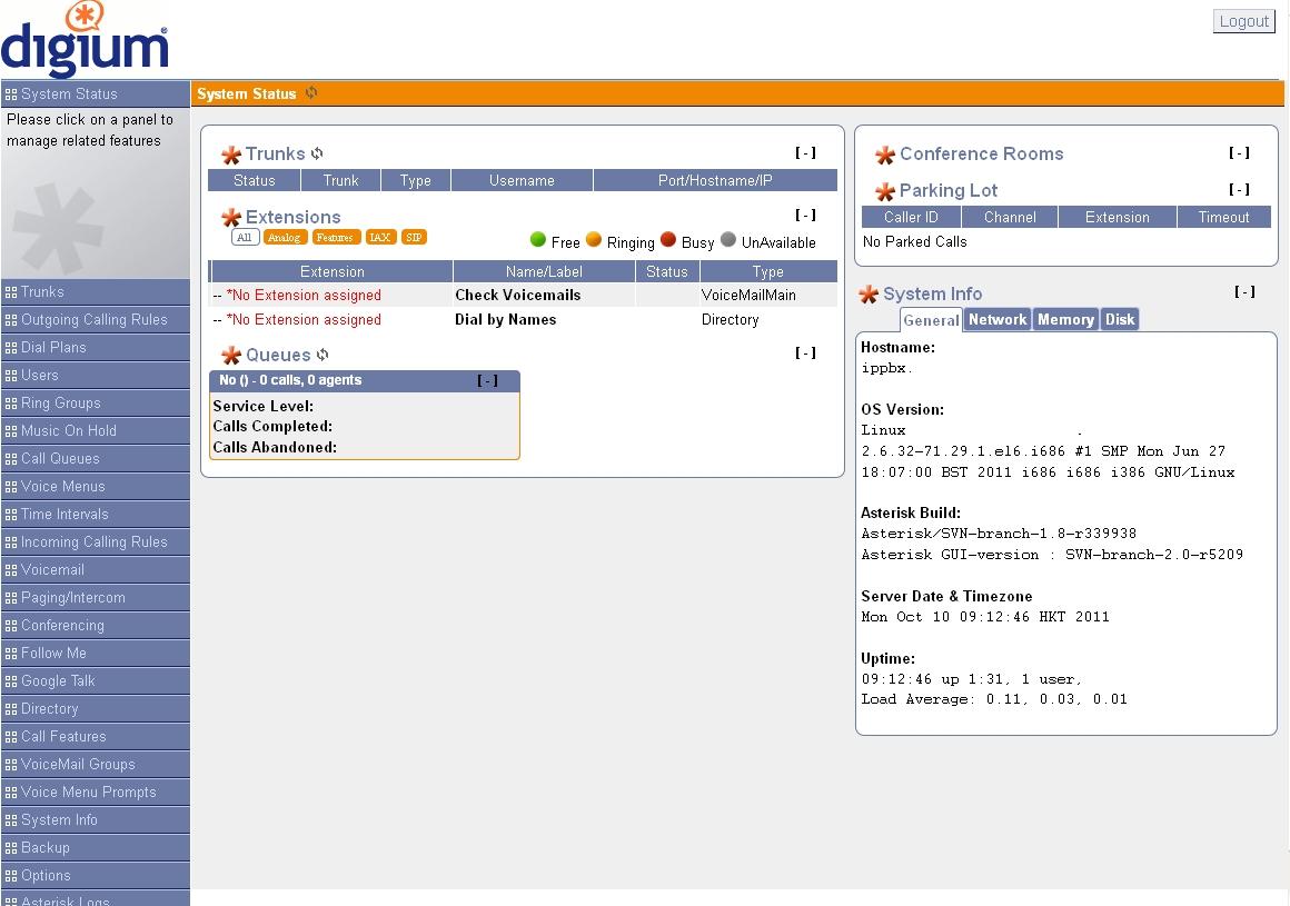

A centos virtual machine within D525 ATOM CPU runs at reasonably ok speed.
But a few hurdles
1. The network issue - fixed based on changing ONBOOT=no to yes;
Finding the network card again and bind to eth0
2. The read write problems; a few errors come in as
- cannot connect to /car/run/asterisk/asterisk.ctl
- asterisk GUI can log inbut show do not have the manager privileges
Cause: security issues behind selinux
Solution: change to permissive or disable mode
The file is located at /etc/selinux/config
Now the GUI can be accessed
圖片附件: screenshot.2.jpg (2011-10-10 09:26, 108.64 KB) / 下載次數 2828
http://www.telecom-cafe.com/forum/attachment.php?aid=956&k=40920c14d9a218bc8b180eba584d2c4c&t=1790639720&sid=3IZq6j

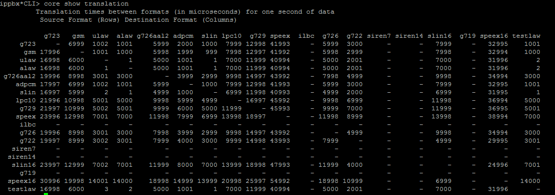

本帖最後由 ckleea 於 2011-10-11 20:35 編輯
Results are not bad
圖片附件: screenshot.11-10-2011 20.26.12.png (2011-10-11 20:34, 14.64 KB) / 下載次數 2909
http://www.telecom-cafe.com/forum/attachment.php?aid=964&k=c313f48818aa06b2545ff4f75d8fb68d&t=1790639720&sid=3IZq6j

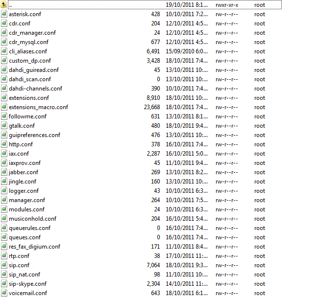

My latest config files in /etc/asterisk
圖片附件: screenshot.19-10-2011 08.39.42.png (2011-10-19 08:48, 39.41 KB) / 下載次數 2878
http://www.telecom-cafe.com/forum/attachment.php?aid=972&k=149c03364ca3110a5c2b6e4b6fb6a5d5&t=1790639720&sid=3IZq6j
