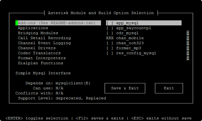

作者: 角色    時間: 2011-10-14 13:27
  1. export PATH=/opt/bin:$PATH
作者: 角色    時間: 2011-10-14 13:32
本帖最後由 角色 於 2011-10-14 13:48 編輯
  1. gcc -g -c -D_GNU_SOURCE -Wall   -c -o menuselect_stub.o menuselect_stub.c
  2. gcc -o menuselect menuselect.o strcompat.o menuselect_stub.o mxml/libmxml.a
  3. make[2]: Leaving directory `/share/HDA_DATA/.qpkg/Optware/src/asterisk/1.8/menuselect'
  4. menuselect/nmenuselect: error while loading shared libraries: libnewt.so.0.52: cannot open shared object file: No such file or directory
  5. menuselect changes NOT saved!
  6. make[1]: Leaving directory `/share/HDA_DATA/.qpkg/Optware/src/asterisk/1.8'
  7. [/opt/src/asterisk/1.8] #
Solved by
  2. export LDFLAGS="-L/opt/lib"
  3. export CFLAGS="-I/opt/include"
  4. export LD_LIBRARY_PATH=/opt/lib
作者: 角色    時間: 2011-10-14 13:38
Finally I am able to obtain the following menuselect image:
圖片附件: 10-14-2011 1-30-28 PM.png (2011-10-14 13:38, 16.95 KB) / 下載次數 2023
http://www.telecom-cafe.com/forum/attachment.php?aid=967&k=bfdd63ece5a3b58451e49132e37595eb&t=1790672287&sid=NjrxUX
