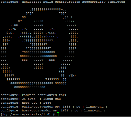

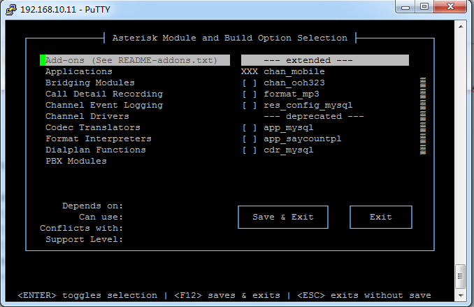

10. If the above command is complete, you will have
11. Make menuselect, we have
12. make
13. make install

16. Please be noted that the above log is based on tarball rather than svn version because it is more easy to reference, maintenance, and comparison.
圖片附件: 0072.png (2012-10-20 02:35, 12.23 KB) / 下載次數 1797
http://www.telecom-cafe.com/forum/attachment.php?aid=1617&k=529551ab42d56c2ff701cbca0671c4c6&t=1790611379&sid=cjQG5X
圖片附件: 0073.png (2012-10-20 02:42, 34.42 KB) / 下載次數 1794
http://www.telecom-cafe.com/forum/attachment.php?aid=1618&k=d8db70e3d233ee28c6467af4d8f1631c&t=1790611379&sid=cjQG5X

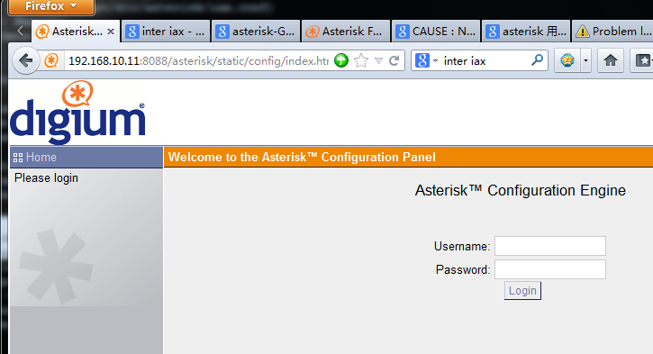

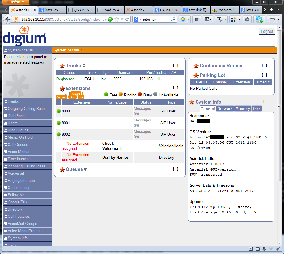

5. Using FireFox browser to
6. Using the login name = admin and the password = admin, as shown previous in Step 4 to login in GUI
7. It takes some time to read the current configuration of the configuration files /opt/etc/asterisk. It would ask you to stop the asterisk program running by the folloiwng command and restart the asterisk again
  1. [/opt/etc/asterisk] # ps aux | grep asterisk
  2. admin     3112  0.0  0.0   4084  1048 pts/1    S+   17:21   0:00 grep asterisk
  3. admin    18371  0.7  0.9  41084 18724 ?        Ssl  10:13   3:02 /opt/sbin/asterisk
  4. [/opt/etc/asterisk] # kill 18371
  5. [/opt/etc/asterisk] # /opt/sbin/asterisk
  6. [/opt/etc/asterisk] #
8. The Asterisk-GUI system will be on the general login mode and waiting for you to enter the login name and password, it gives
9. Now you are able to configure your Asterisk with the Asterisk-GUI.

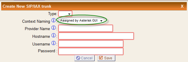

作者: 角色    時間: 2012-10-20 17:10
本帖最後由 角色 於 2012-10-20 17:17 編輯

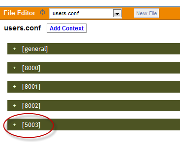

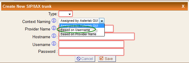

Inter IAX: incoming trunk call from Asterisk 1.4 to Asterisk 1.8 Authentication problem
因为在起trunk的时候,context naming用了Asterisk-GUI,导致在users.conf里的context name是什么trunk等字句。当然Asterisk 1.4的incoming trunk进来的时候(如果在Asterisk开了5003做trunk),incoming的username=5003,但是在users.conf里属于5003的registration的context是那个trunk name,与是Asterisk找不到后,就说authentication problem。
在设trunk的时候,context name要选用username,如下图:
其他的设定就如一样那样set。
设好后,就save,apply changes,在用File Editor看看users.conf里是有5003的context,如果有,就代表设置完成。
圖片附件: 0076.png (2012-10-20 17:11, 19.44 KB) / 下載次數 1726
http://www.telecom-cafe.com/forum/attachment.php?aid=1619&k=3ac2daf8f8d416daf888eec1aa624f8a&t=1790611379&sid=cjQG5X
圖片附件: 0077.png (2012-10-20 17:13, 21.57 KB) / 下載次數 1714
http://www.telecom-cafe.com/forum/attachment.php?aid=1620&k=4490269e32bb688bb08b3811c78906d3&t=1790611379&sid=cjQG5X
圖片附件: 0078.png (2012-10-20 17:17, 10.88 KB) / 下載次數 1709
http://www.telecom-cafe.com/forum/attachment.php?aid=1621&k=a16ca15a31f74bef684e6687d0390bb7&t=1790611379&sid=cjQG5X

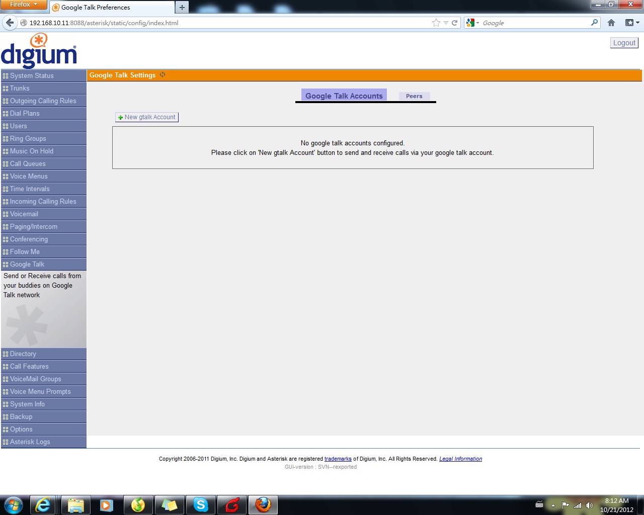

角色師兄, 我剛剛發現你幫我tar的Asterisk GUI比ipkg Asterisk GUI多了Google Talk一項:
圖片附件: Qnap Asterisk-GUI2.jpg (2012-10-21 08:24, 174.51 KB) / 下載次數 1758
http://www.telecom-cafe.com/forum/attachment.php?aid=1624&k=4149f40fcca7e099976ec8b7d0c54e5f&t=1790611379&sid=cjQG5X
作者: 角色    時間: 2012-10-21 08:42
回復 20# 雯雯
我都没有详细给你看,因为给你弄好系统的时候已经深夜3点几,眼花花!
我重看我之前发的帖子(第5楼最后的图片)有Google Talk字样!不过应该用不到!要之前安装其他package,然后在make menuselect再选,选好后加入Google Voice账号就可以。不过Asterisk 1.8的Google Support不是太好!打出是没有问题,但是Asterisk 1.8的接入是有问题。估计这个问题在Asterisk 11才能解决好!因为Asterisk 11用比较标准的XMPP。

回復 20# 雯雯
Google Talk 並不是使用了 tar 便可以有,要安裝另外兩個package,然後再compile Asterisk 一次就可以在GUI 版面見到的。
# ipkg install iksemel
# ipkg install openssl openssl-dev
