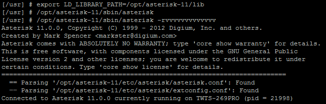

Just downloaded the tarball of Asterisk 11 from the Asterisk Official website and carried out the compilation process. When I execute the scripts
  1. [/usr] # /opt/asterisk-11/sbin/asterisk
  2. /opt/asterisk-11/sbin/asterisk: error while loading shared libraries: libasteriskssl.so.1: cannot open shared object file: No such file or directory

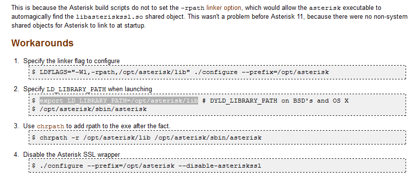

This error could be removed by a number of ways as described in Link which are summarised below:
Since I would like to see the compilation result then I chose the second method, it gave:
Later I would like to switch back to use the first method.

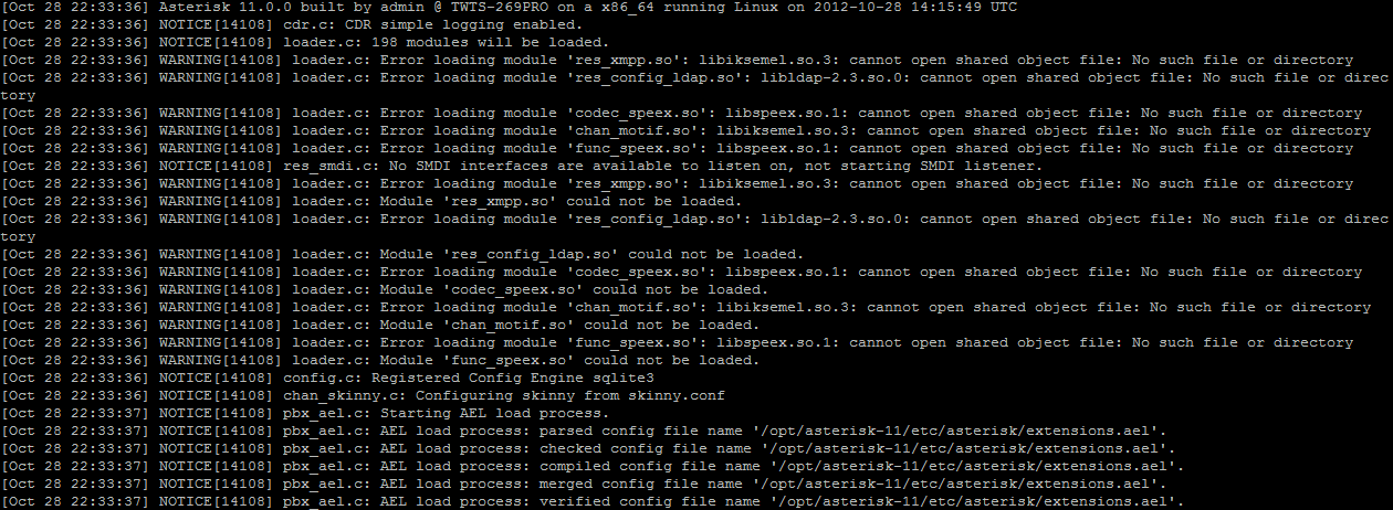

The missing libraries are being kept in /opt/lib. Once we tell the system, the loadable library path = /opt/lib (shown below) and followed by restarting the asterisk, we are able to get speex and speex16 codecs and other error message were gone.
  1. export LD_LIBRARY_PATH=/opt/lib

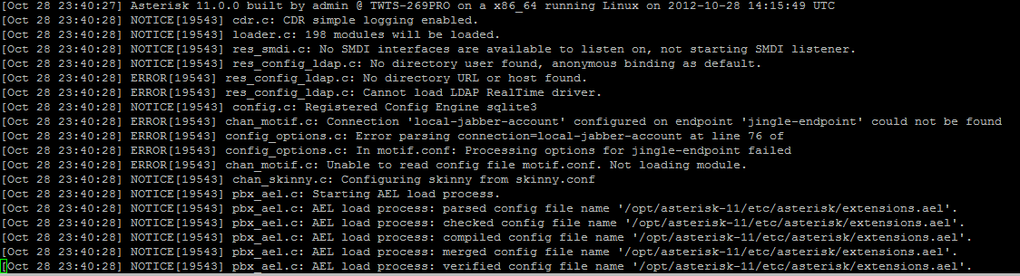

The error message in "/opt/asterisk-11/var/lib/asterisk/message" is

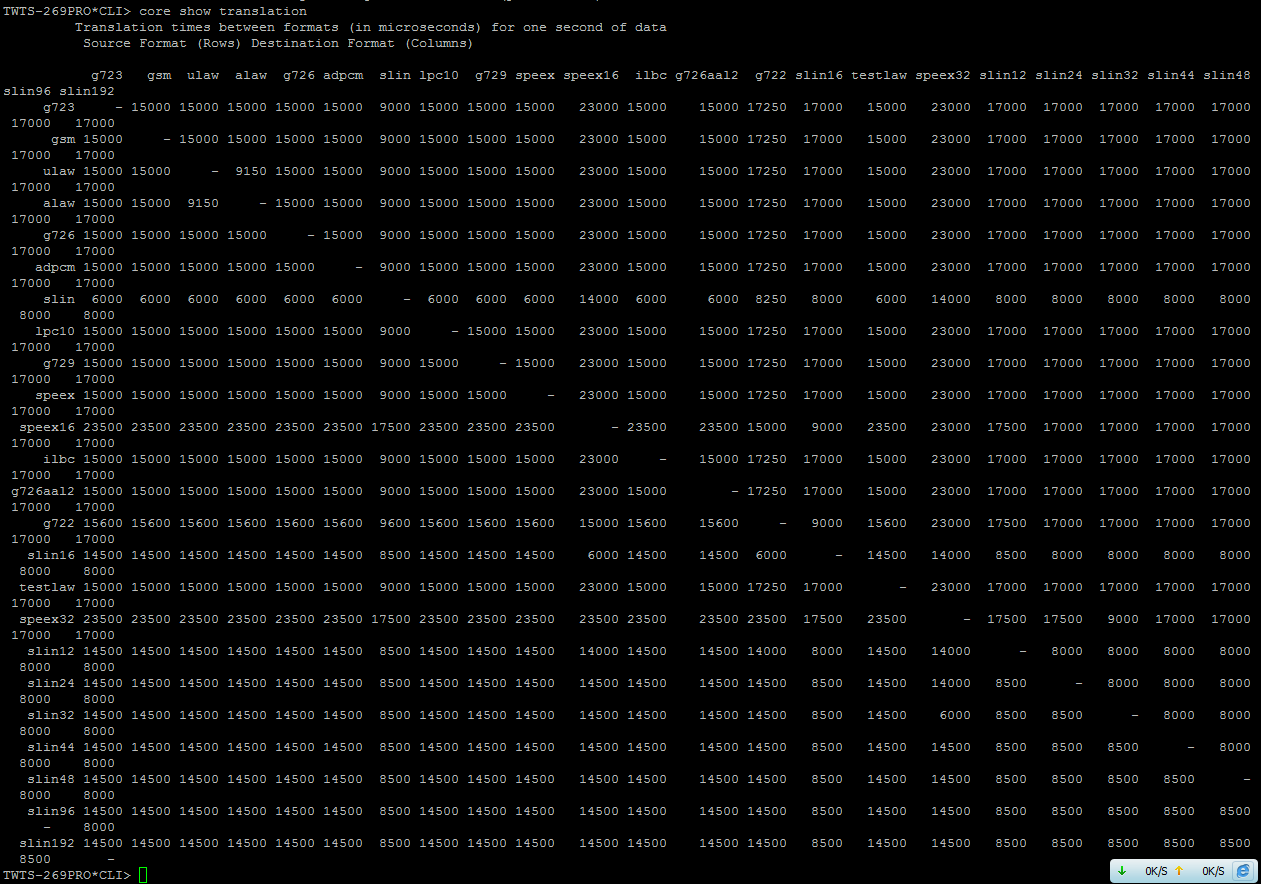

After having applied the above processes, we carried out the command "core show translation", we got

Just for informatin, if we use the workarounds 4 as below, there is no need to recall the library path "export LD_LIBRARY_PATH=/opt/lib" as you advised.
./configure --prefix=/opt/asterisk-11 --disable-asteriskssl
However, I don't know which one is the best and what will be the impact if we disable asteriskssl in the cofiguration process.

如果你安裝的路徑跟我一樣是 /opt/src/asterisk/asterisk-11,那麼,compile 時可以打:
LDFLAGS="-Wl,-rpath,/opt/asterisk-11/lib" ./configure --prefix=/opt/asterisk-11
可以解決該error問題。

你看我们都是这样invoke的:
  1. [/opt/etc/asterisk] # /opt/asterisk-11/sbin/asterisk
  2. [/opt/etc/asterisk] # /opt/asterisk-11/sbin/asterisk -rvvvvvvvvv
  3. Asterisk 11.0.0, Copyright (C) 1999 - 2012 Digium, Inc. and others.
  4. Created by Mark Spencer <markster@digium.com>
  5. Asterisk comes with ABSOLUTELY NO WARRANTY; type 'core show warranty' for details.
  6. This is free software, with components licensed under the GNU General Public
  7. License version 2 and other licenses; you are welcome to redistribute it under
  8. certain conditions. Type 'core show license' for details.
  9. =========================================================================
  10.   == Parsing '/opt/asterisk-11/etc/asterisk/asterisk.conf': Found
  11.   == Parsing '/opt/asterisk-11/etc/asterisk/extconfig.conf': Found
  12. Connected to Asterisk 11.0.0 currently running on TWTS-269PRO (pid = 8968)
  13. TWTS-269PRO*CLI>
