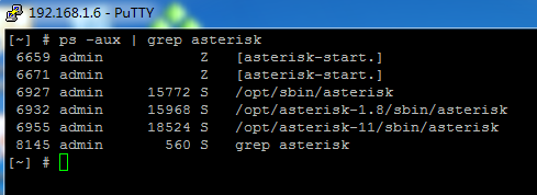

10. Reboot using webadmin
11. After reboot, we are able to see three Asterisk servers running in parallel.

圖片附件: 0094.png (2012-10-29 03:46, 16.7 KB) / 下載次數 1792
http://www.telecom-cafe.com/forum/attachment.php?aid=1783&k=20877f0930ccc59f351e1b3a860c258f&t=1790630103&sid=caK33P

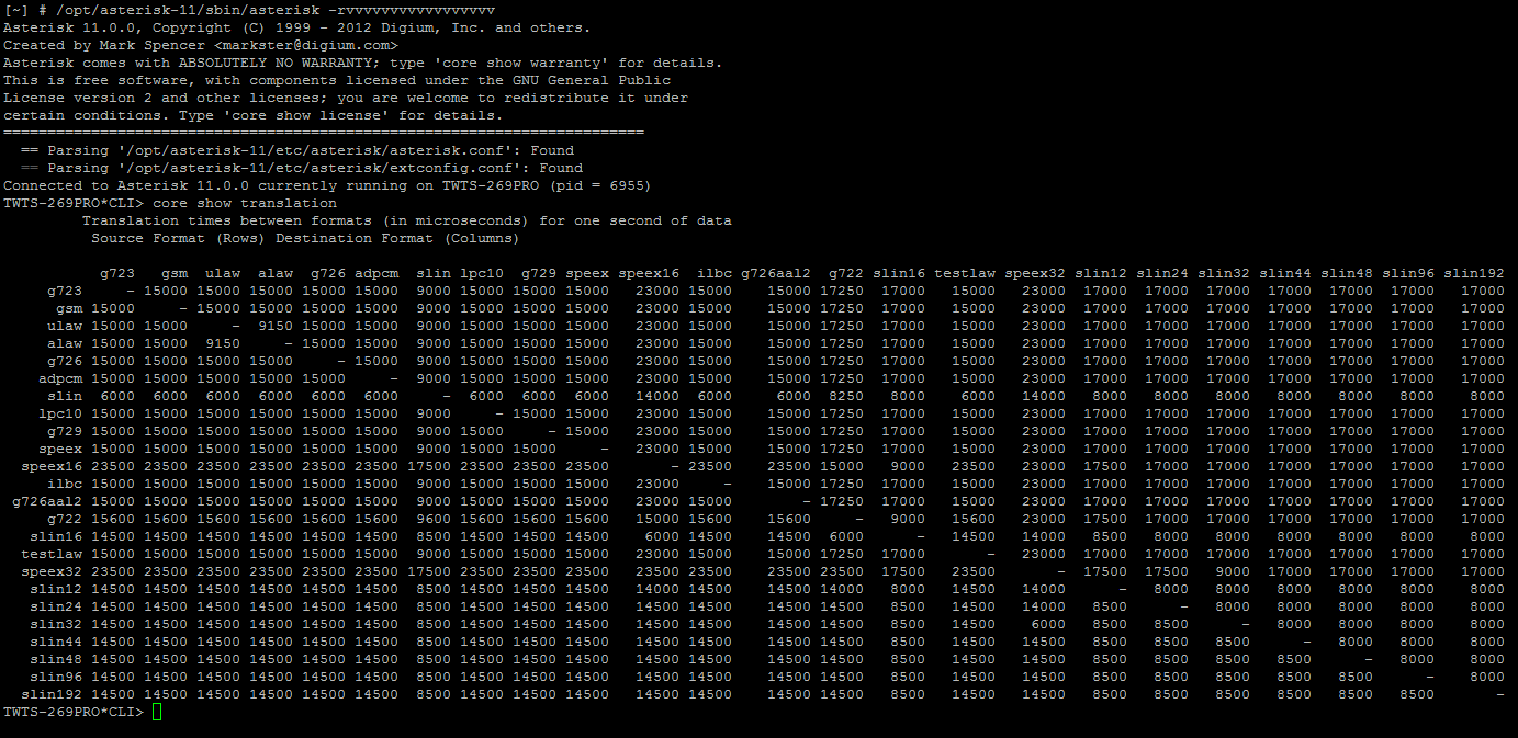

Using the above autorun.sh script, the core show translation for Asterisk 11, we have
圖片附件: 1007.png (2012-10-29 09:00, 49.67 KB) / 下載次數 1717
