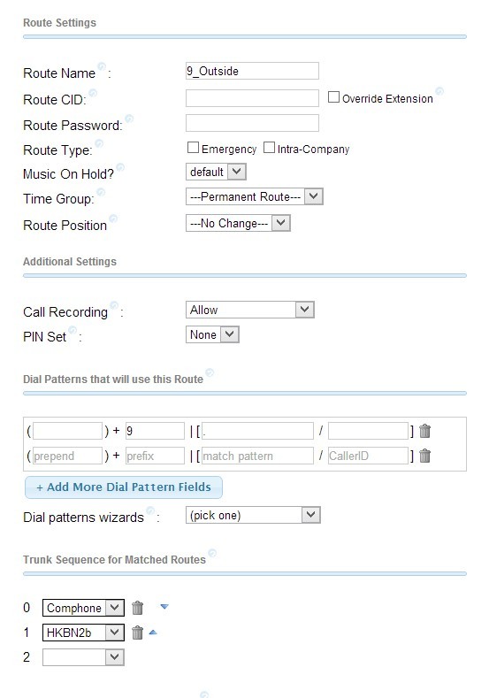

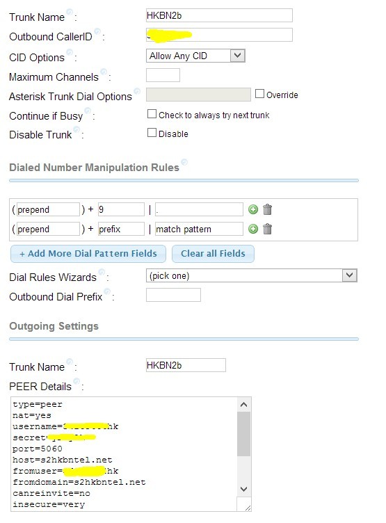

[attach]1966[/attach] 未命名.jpg 未命名1.jpg 未命名2.jpg 未命名5.jpg
c-hing  可否發幾張Trunk,inbound routes,outbound routes 設定 圖參考下?
andyng 發表於 2012-11-22 10:27
圖片附件: [RASPBX] 未命名.jpg (2012-11-25 23:56, 113.29 KB) / 下載次數 1675
http://www.telecom-cafe.com/forum/attachment.php?aid=1963&k=189fc9abccf5dafacd4e6f87711b61f8&t=1790648835&sid=ezz8qL
圖片附件: [TRUNK CM] 未命名1.jpg (2012-11-25 23:56, 77.26 KB) / 下載次數 1682
http://www.telecom-cafe.com/forum/attachment.php?aid=1964&k=1a0dffa77c7cf02b2cb8a42cae803685&t=1790648835&sid=ezz8qL
圖片附件: [TRUNK HK2B] 未命名2.jpg (2012-11-25 23:56, 73.33 KB) / 下載次數 1659
http://www.telecom-cafe.com/forum/attachment.php?aid=1965&k=fd65638e1ba1666de675d2691920322d&t=1790648835&sid=ezz8qL
圖片附件: [OUTROUTE] 未命名5.jpg (2012-11-25 23:56, 64.78 KB) / 下載次數 1696
http://www.telecom-cafe.com/forum/attachment.php?aid=1968&k=0144da769e200fdcdc7a3a1db38d7610&t=1790648835&sid=ezz8qL

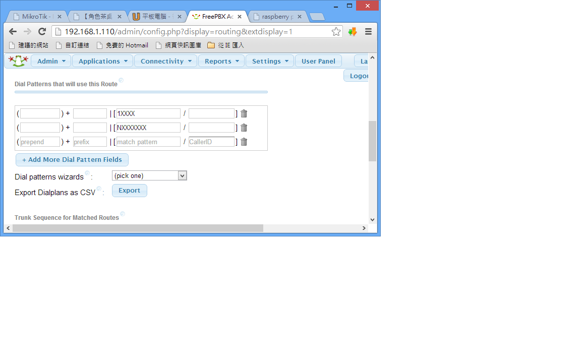

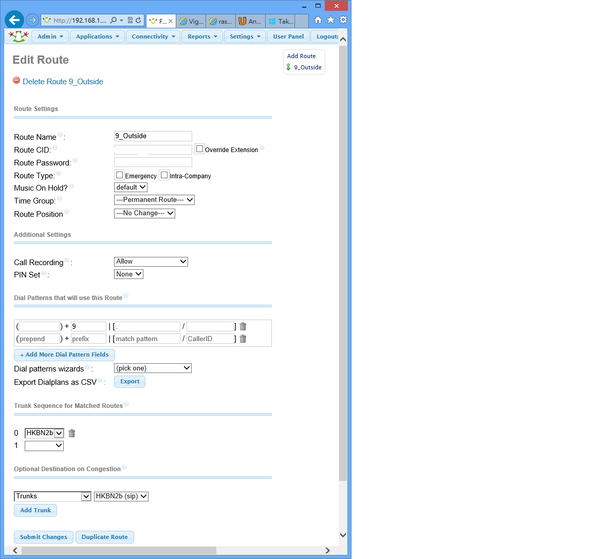

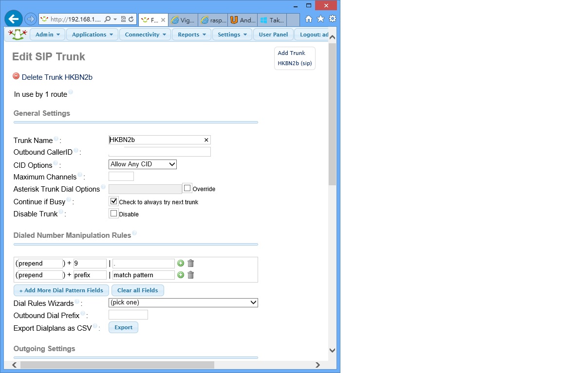

I've problem to call a mobile phone no. start from 9xxxxxxx so I suspected something wrong in the dial pattern whether under Trunk or Outbound Routes.
I put '9' in prefix and '.' in match pattern only. The logfile shown 'tdial' instead of 9xxxxxxx.
作者: dreamy2k    時間: 2012-12-20 15:26
回復 43# Thunderman
你COPY個TRUNK同Outbound Routes出來看看呀
作者: Thunderman    時間: 2012-12-20 22:36
See attached.
圖片附件: [Outbound Route] 1.png (2012-12-20 22:35, 54.96 KB) / 下載次數 2014
http://www.telecom-cafe.com/forum/attachment.php?aid=2074&k=d88012a05445983ffea883899783868f&t=1790648835&sid=ezz8qL
圖片附件: [HKBN Trunk] 2.jpg (2012-12-20 22:35, 123.55 KB) / 下載次數 1990
http://www.telecom-cafe.com/forum/attachment.php?aid=2075&k=2ec49ba94aef36d54862f698697b91a1&t=1790648835&sid=ezz8qL
作者: dreamy2k    時間: 2012-12-21 22:07
回復 45# Thunderman
系呢度"Optional Destination on Congestion"我無加任何野喎
作者: bigtoodog    時間: 2012-12-22 12:31

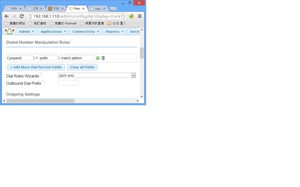

作者: Thunderman    時間: 2012-12-23 20:57
回復 46# dreamy2k
It works now after remove the content under Dialed Number Manipulation Rules in the Trunk and changed the Dial Patterns in outbound route as attached.
圖片附件: [Trunk] 1.jpg (2012-12-23 20:56, 82.66 KB) / 下載次數 1954
http://www.telecom-cafe.com/forum/attachment.php?aid=2076&k=40a3a359f2fa047ead69996ea2a8dea2&t=1790648835&sid=ezz8qL
圖片附件: [Outbound Route] 2.jpg (2012-12-23 20:56, 49.68 KB) / 下載次數 1947
http://www.telecom-cafe.com/forum/attachment.php?aid=2077&k=cdafbb8e1673692ba841af68844942fb&t=1790648835&sid=ezz8qL
