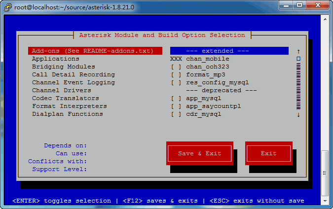

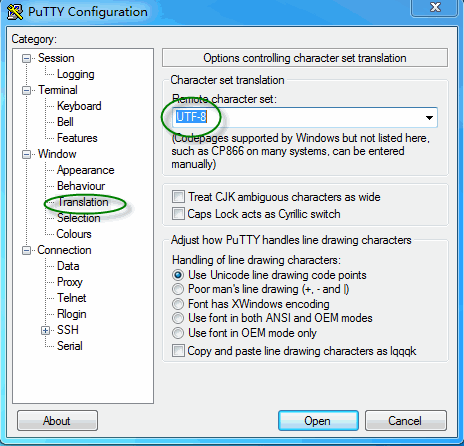

10. Run ./configure again
11. make menuselect, it gives
If you see message code around the box and if you are using putting to login the system, then you can fix it by using UTF-8 coding, as shown below:
圖片附件: 1062.gif (2013-4-21 23:30, 24.17 KB) / 下載次數 1311
http://www.telecom-cafe.com/forum/attachment.php?aid=2435&k=5af32c69612052530a6462940d2d089e&t=1790667315&sid=TTDHnh
圖片附件: 1063.gif (2013-4-21 23:31, 23.86 KB) / 下載次數 1248
http://www.telecom-cafe.com/forum/attachment.php?aid=2436&k=3d01a9cde6d38116de2556358febb0d1&t=1790667315&sid=TTDHnh
