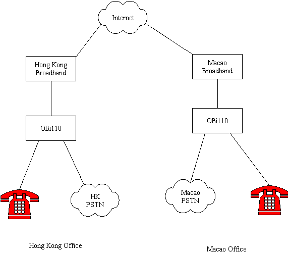

先用OBi110,就PSTN和VoIP結合。
圖片附件: Hongkong-Macao.gif (2013-5-18 23:13, 5.71 KB) / 下載次數 2599

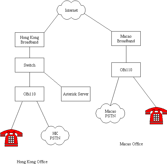

如果加一個Asterisk Server,那麼你撥打電話就更加方便和暢通。
圖片附件: Hongkong-Macao 2.gif (2013-5-19 00:25, 6.57 KB) / 下載次數 2593

原来orangelau两边公司都有Synology NAS,那么问题更加简单。
还有他在澳门的office都有optical fibre接入。
作者: alexccy    時間: 2013-5-20 19:21
澳門的nas 如何接入pstn?
作者: 角色    時間: 2013-5-20 21:07
回復 21# alexccy
NAS是安装Asterisk Server,然后通过OBi110的FXO口就澳门PSTN就可以。
作者: 角色    時間: 2013-5-20 22:05
Emergency plan for Hong Kong and Macao Telephony system in case of any problem in the current VoIP system:
Use two OBi110s and install each in Hong Kong and Macao Offices.

作者: alexccy    時間: 2013-5-21 11:31
May i know the dial plan ,if i using OBi110s as FXO Gateway ?
作者: 角色    時間: 2013-5-21 13:34
本帖最後由 角色 於 2013-5-21 13:39 編輯
回復 26# alexccy
Using OBi110 as FXO gateway for Asterisk Server
1. Create a SIP account to OBi110 SP2 as follows:
sip.conf
;TW OBi110 SP2
[1910]
type=friend
username=TW OBi110
secret=password for SP2 of OBi110
host=dynamic
canreinvite=no
dtmfmode = auto
context=internal
2. Generate suitable dialplan in Asterisk server for the resource available
Prefix = 111. (**1 resoruce, SP1)
Prefix = 118. (**8 resoruce, PSTN FXO)
Prefix = 001. (**1 resoruce, SP1, GV)
Prefix = 00852. (**8 resoruce, PSTN FXO if connected HK PSTN fixed line)
Prefix = 119. (**9 resoruce, Obitalk)
extensions.conf
;110 OBi110 AA
[trunk-obi110-aa]
exten => _110,1,Dial(SIP/**0@1910,,)
exten => _110,n,Hangup()
;111 OBi110 GV
[trunk-obi110-gv]
exten => _111.,1,Dial(SIP/**1${EXTEN:3}@1910,,)
exten => _111.,n,Hangup()
;118 OBi110 PSTN
[trunk-obi110-pstn]
exten => _118.,1,Dial(SIP/**8${EXTEN:3}@1910,,)
exten => _118.,n,Hangup()
;001 OBi110 PSTN
[trunk-obi110-pstn-001]
exten => _001.,1,Dial(SIP/**1${EXTEN:3}@1910,,)
exten => _001.,n,Hangup()
;00852 OBi110 OBiTalk
[trunk-obi110-pstn-00852]
exten => _00852.,1,Dial(SIP/**8${EXTEN:5}@1910,,)
exten => _00825.,n,Hangup()
;119 OBi110 OBiTalk
[trunk-obi110-obitalk]
exten => _119.,1,Dial(SIP/**9${EXTEN:3}@1910,,)
exten => _119.,n,Hangup()
