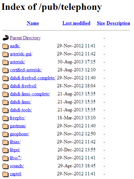

作者: 角色    時間: 2013-9-16 23:17
The tarballs of each version is obtainable in the following website:
http://downloads.asterisk.org/pub/telephony/

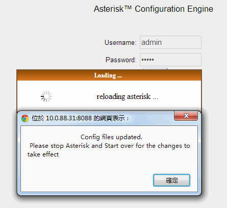

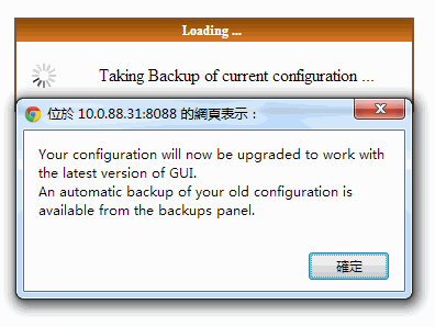

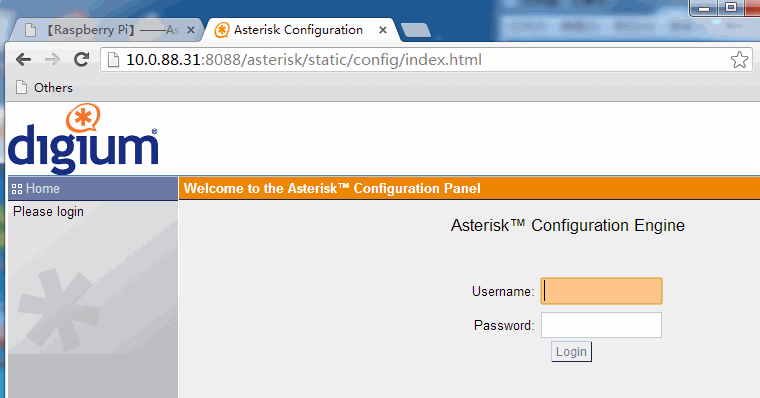

作者: 角色    時間: 2013-9-17 20:46
本帖最後由 角色 於 2013-9-17 20:47 編輯
Restart the Asterisk server
Using a browser with the following address
http://10.0.88.31:8088/asterisk/static/config/index.html
or
user=admin, password=admin
Follow the message box and restart the Asterisk server
