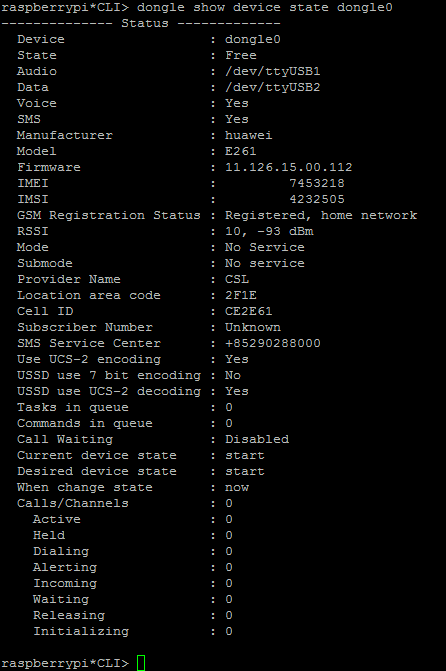

在还没有做好基本的Asterisk server安装前,本人现对3G在Voice,Data,SMS作资料收集。
Tutorial for Huawei 3G modem
http://wiki.e1550.mobi/doku.php
The source code for asterisk data dongle could be obtainable in the following path:
https://code.google.com/p/asterisk-chan-dongle/

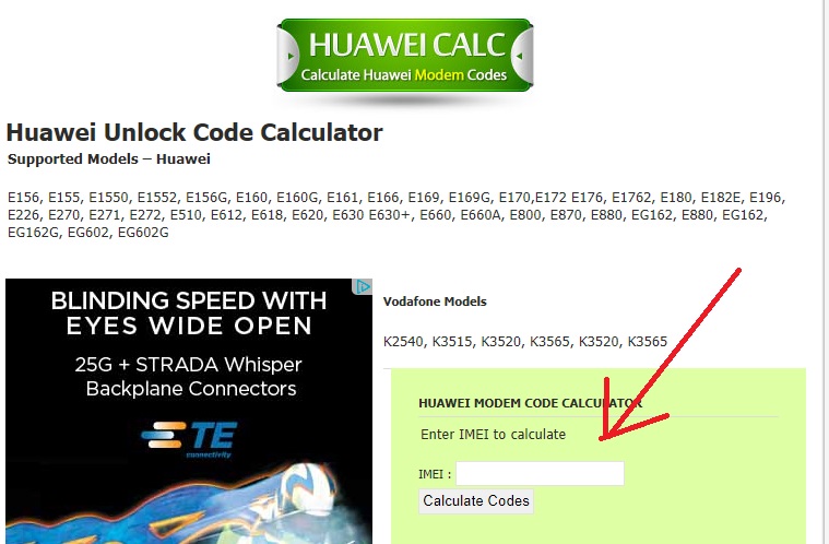

作者: SuiYan    時間: 2013-9-22 00:38
用hkepc方法, 在網頁打入imei , 在網頁上generate出密碼, 再用datacard-unlock 程式去unlock.
網頁 : http://www.wintechmobiles.com/tools/huawei-code-calculator/
unlock 程式 :
datacard-unlock.zip (25.25 KB)
附件: [datacard-unlock] datacard-unlock.zip (2013-9-22 00:32, 25.25 KB) / 下載次數 2830
http://www.telecom-cafe.com/forum/attachment.php?aid=2790&k=c3d60f85f4256fde2231d4b80b51e931&t=1790640527&sid=m9Y7m4
圖片附件: [IMEI Gen] HuaweiModemKeyGen.jpg (2013-9-22 00:38, 102.13 KB) / 下載次數 1610
http://www.telecom-cafe.com/forum/attachment.php?aid=2791&k=9e6c05ee5eb856e23ddaa135b8907314&t=1790640527&sid=m9Y7m4

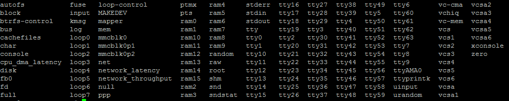

Finally I managed to get the device /dev/ttyUSB0 and /dev/ttyUSB1 by the following and important command:
apt-get install usb-modeswitch
作者: 角色    時間: 2013-10-27 23:02
If I used the command lsusb, it gave
  1. root@raspberrypi:~# lsusb
  2. Bus 001 Device 002: ID 0424:9512 Standard Microsystems Corp.
  3. Bus 001 Device 001: ID 1d6b:0002 Linux Foundation 2.0 root hub
  4. Bus 001 Device 003: ID 0424:ec00 Standard Microsystems Corp.
  5. Bus 001 Device 009: ID 8564:4000
  6. Bus 001 Device 012: ID 12d1:1003 Huawei Technologies Co., Ltd. E220 HSDPA Modem / E230/E270/E870 HSDPA/HSUPA Modem
  7. Bus 001 Device 010: ID 046d:c31d Logitech, Inc.
More modems it gives after having isntalled the usb-modeswitch package.
作者: 角色    時間: 2013-10-27 23:04
When I checked the device /dev/ttyUSBX port, I got
  1. root@raspberrypi:/dev# ls -l ttyU*
  2. crw-rw---T 1 root dialout 188, 0 Oct 27 22:57 ttyUSB0
  3. crw-rw---T 1 root dialout 188, 1 Oct 27 22:57 ttyUSB1

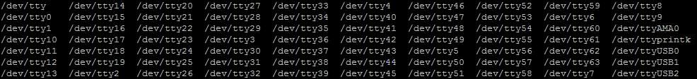

The above results I got were with a powered USB hub. If I plugged the modem directly in the Raspberry Pi box with a very good USB DC power of 2000mA, an interesting results were obtained.
  5. Bus 001 Device 004: ID 12d1:1446 Huawei Technologies Co., Ltd. E1552/E1800/E173 (HSPA modem)
  6. root@raspberrypi:~# ls /dev/tty*
  7. /dev/tty    /dev/tty19  /dev/tty3   /dev/tty40  /dev/tty51  /dev/tty62
  8. /dev/tty0   /dev/tty2   /dev/tty30  /dev/tty41  /dev/tty52  /dev/tty63
  9. /dev/tty1   /dev/tty20  /dev/tty31  /dev/tty42  /dev/tty53  /dev/tty7
  10. /dev/tty10  /dev/tty21  /dev/tty32  /dev/tty43  /dev/tty54  /dev/tty8
  11. /dev/tty11  /dev/tty22  /dev/tty33  /dev/tty44  /dev/tty55  /dev/tty9
  12. /dev/tty12  /dev/tty23  /dev/tty34  /dev/tty45  /dev/tty56  /dev/ttyAMA0
  13. /dev/tty13  /dev/tty24  /dev/tty35  /dev/tty46  /dev/tty57  /dev/ttyprintk
  14. /dev/tty14  /dev/tty25  /dev/tty36  /dev/tty47  /dev/tty58
  15. /dev/tty15  /dev/tty26  /dev/tty37  /dev/tty48  /dev/tty59
  16. /dev/tty16  /dev/tty27  /dev/tty38  /dev/tty49  /dev/tty6
  17. /dev/tty17  /dev/tty28  /dev/tty39  /dev/tty5   /dev/tty60
  18. /dev/tty18  /dev/tty29  /dev/tty4   /dev/tty50  /dev/tty61
  19. root@raspberrypi:~#
It is seen from the above results, the modem features using lsusb is different from the previous results that I got. Also the there was no /dev/ttyUSBX port.

Finally I was able to set up 3G modem (both outbound and inbound calls) using a light editing process and then the rest of tasks could be done by the Asterisk-GUI.
作者: SuiYan    時間: 2013-11-3 22:09

作者: 角色    時間: 2013-11-3 22:28
For your reference, I attached two screen captures as shown below:
圖片附件: 1085a.gif (2013-11-3 22:28, 4.55 KB) / 下載次數 2122
http://www.telecom-cafe.com/forum/attachment.php?aid=2897&k=b682508ffa5d9b5c0b3418885e647f41&t=1790640527&sid=m9Y7m4
圖片附件: 1085b.gif (2013-11-3 22:28, 13.92 KB) / 下載次數 2048
http://www.telecom-cafe.com/forum/attachment.php?aid=2898&k=ee21ebd58fa8887cc677db12f72bec5f&t=1790640527&sid=m9Y7m4
作者: 角色    時間: 2013-11-3 22:32
Please make sure that you are able to see /dev/ttyU* as shown below:
圖片附件: 1086.gif (2013-11-3 22:32, 2.67 KB) / 下載次數 2074
http://www.telecom-cafe.com/forum/attachment.php?aid=2899&k=f08a025658a5ba2bf133cc5559e8896a&t=1790640527&sid=m9Y7m4
