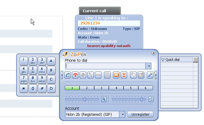

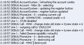

zoiper can register again
but never dial in dial out
error : "bearer capability not auth"

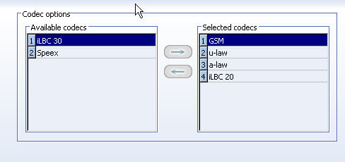

after google it hint to be codec, so I attach what codec used
any hints

作者: tsm    時間: 2013-10-5 18:01
ok
finally i work again
after I apply stun
so I have to study what is stun server
what will be your recommend reading
