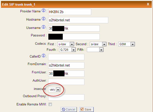

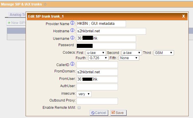

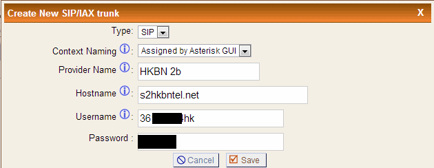

Asterisk-GUI Settings for NWT Internet/Broadband Phone Link
Asterisk-GUI Settings for ComNet Phone Link
Asterisk-GUI Settings for HKBN 2b Phone Link
NWT and ComNet Phone register string (Asterisk)和 打出问题

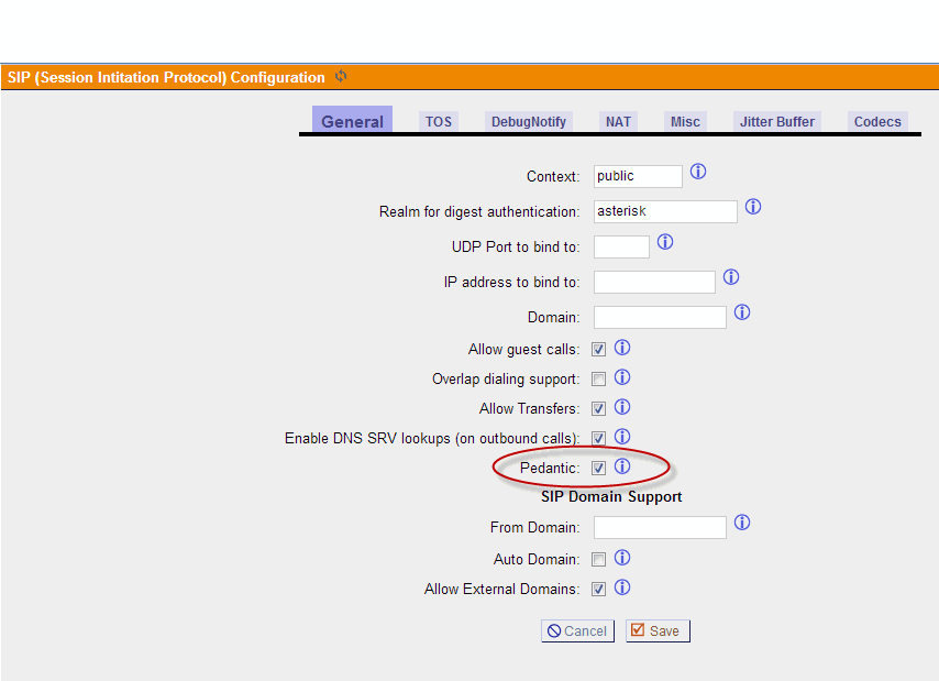

就是要加 qualify=no

好了,大家可以写了,那么我会做链接。

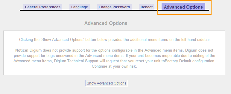

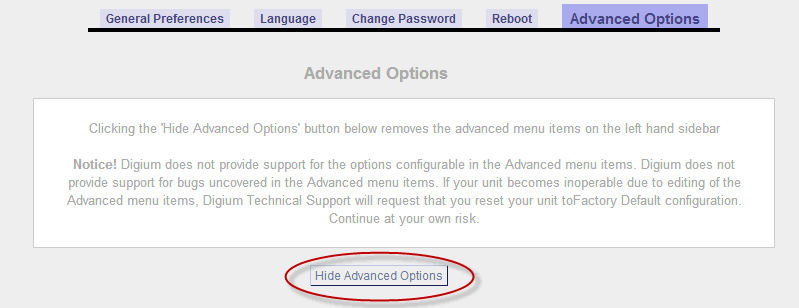

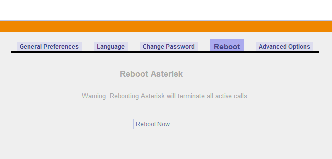

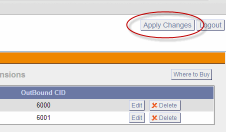

怎样show advanced options?
1. 点击在右上角的button
2. 留意最底部的变化
3. 多处的options
圖片附件: 1067a.gif (2013-10-14 20:34, 13.61 KB) / 下載次數 2046

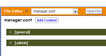

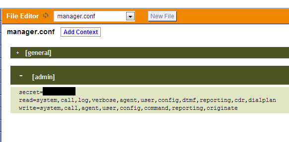

怎样更改login name and password?
有两个方法去修改login name and password.那些credentials放在manager.conf。
第一种方法
ssh login + vi /etc/asterisk/manager.conf
At the end of manager.conf
  1. [admin]
  2. secret=admin
  3.   read=system,call,log,verbose,agent,user,config,dtmf,reporting,cdr,dialplan
  4.   write=system,call,agent,user,config,command,reporting,originate
在上面"[admin]",是login name:admin。Password放在secret,那么password就是admin。你可以作适当的修改就可以。

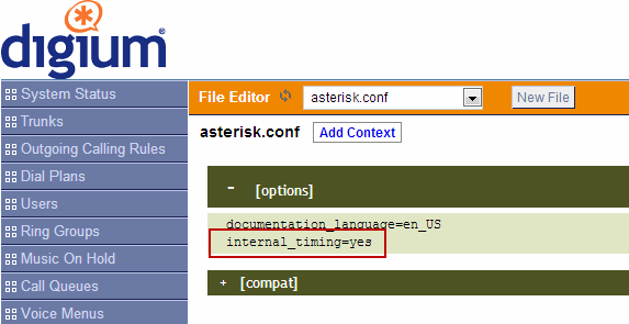

第二种方法
1. 先enable advanced options Link
2. 在左右边的advanced otpions里,点击“File Editor”,然后选manager.conf
修改secret的content就可以更改password
修改login name就比较复杂一点。就先先creat 一个新的context,然后copy之前”-admin“下的资料,然后save,再apply changes。

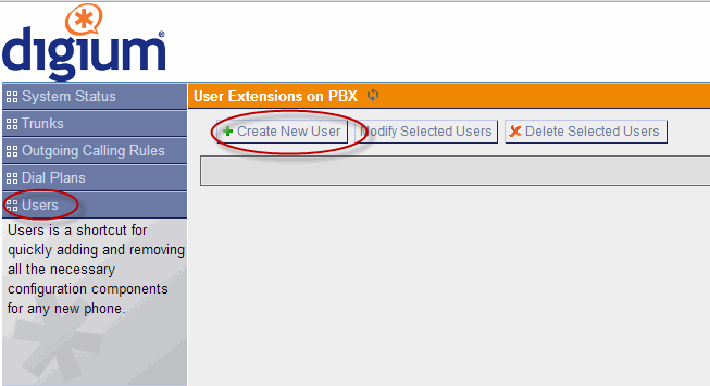

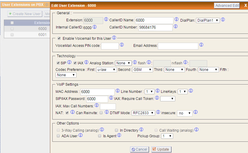

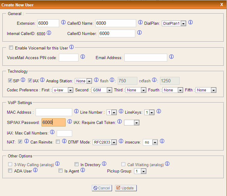

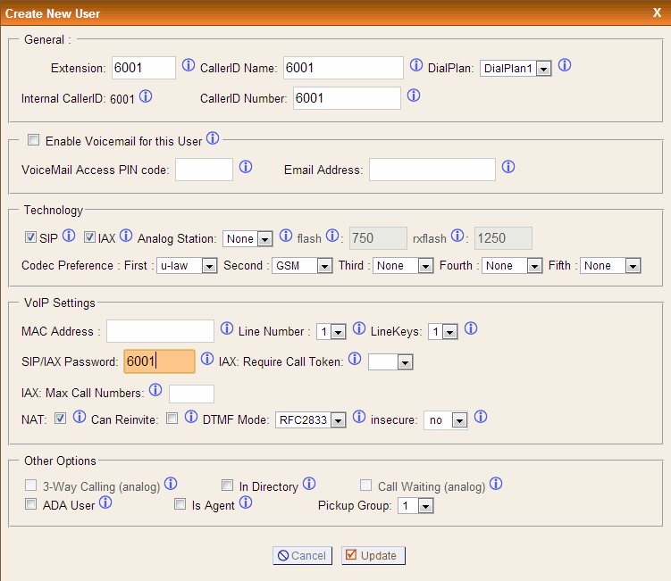

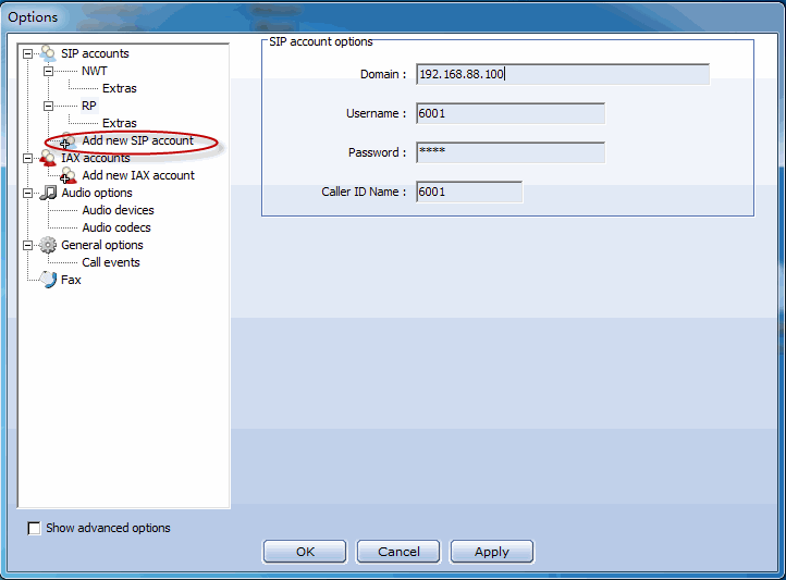

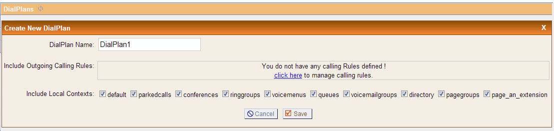

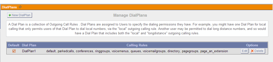

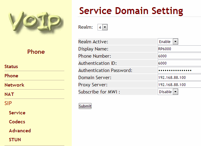

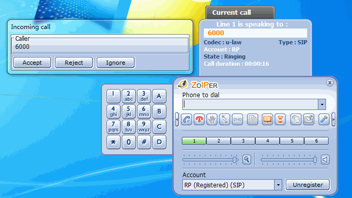

Internal SIP call
Extension 6000 = SIP Client 1(IP Phone)
Extension 6001 = SIP Client 2(Zoiper softphone)
1. Create a dialplan
2. Create two extensions
2a. Create Extension 6000
2b. Create Extension 6001
3. Apply changes
4. SIP Client 1 (IP Phone)
5. SIP Client 2 (Zoiper Softphone)
6. Test
圖片附件: 1069a.gif (2013-10-15 23:16, 14.71 KB) / 下載次數 2135

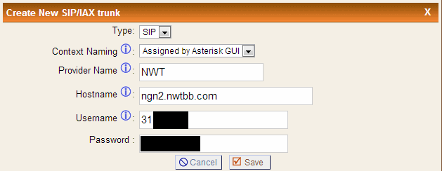

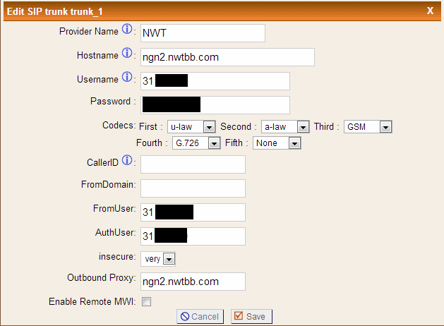

Please note that the softswitch (Huawei SoftX3000 V300R010) of NWT is the same as ComNet Phone using, therefore the settings for ComNet Phone is also applicable to NWT Phone.
  1. <--- SIP read from UDP:203.176.254.198:5060 --->
  2. INVITE sip:33445566@192.168.88.100:5060;user=phone SIP/2.0
  3. Via: SIP/2.0/UDP 203.176.254.198:5060;branch=z9hG4bKblxcvluokkhnjxnjo78civlhv
  4. Call-ID: SBCqlhluppq5cuxwcpxgmgcwulbygvvvgcy@SoftX3000
  5. From: <sip:96331111@203.176.254.198>;tag=wq8xxuul-CC-22
  6. To: <sip:33445566@58.153.143.183:30628;user=phone>
  7. CSeq: 1 INVITE
  8. Allow: INVITE,ACK,OPTIONS,BYE,CANCEL,REGISTER,INFO,PRACK,SUBSCRIBE,NOTIFY,UPDATE,MESSAGE,REFER
  9. Max-Forwards: 70
  10. Supported: 100rel
  11. User-Agent: Huawei SoftX3000 V300R010
  12. Contact: <sip:96331111@203.176.254.198:5060;user=phone>
  13. Content-Length: 427
  14. Content-Type: application/sdp
  15. v=0
  16. o=HuaweiSoftX3000 93845972 93845972 IN IP4 203.176.254.198
  17. s=Sip Call
  18. c=IN IP4 203.176.254.198
  19. t=0 0
  20. m=audio 23684 RTP/AVP 8 0 18 4 2 97 98 101
  21. a=rtpmap:8 PCMA/8000
  22. a=rtpmap:0 PCMU/8000
  23. a=rtpmap:18 G729/8000
  24. a=rtpmap:4 G723/8000
  25. a=rtpmap:2 G726-32/8000
  26. a=rtpmap:97 G726-40/8000
  27. a=rtpmap:98 G726-32/8000
  28. a=rtpmap:101 telephone-event/8000
  29. a=ptime:20
  30. a=fmtp:101 0-15
  31. a=fmtp:18 annexb=yes
  32. a=fmtp:4 annexa=yes

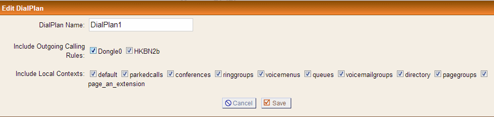

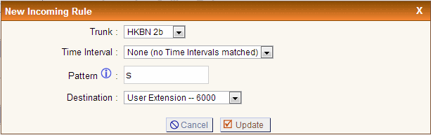

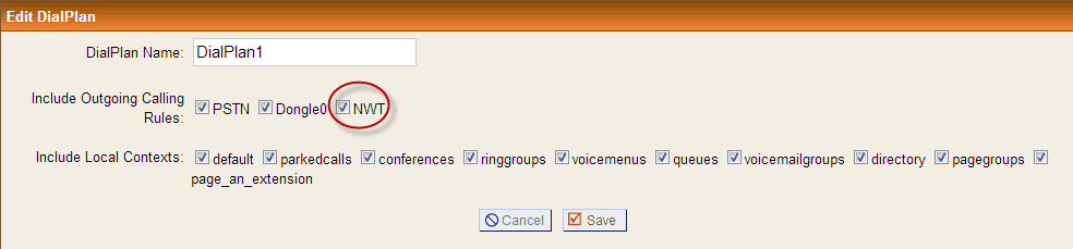

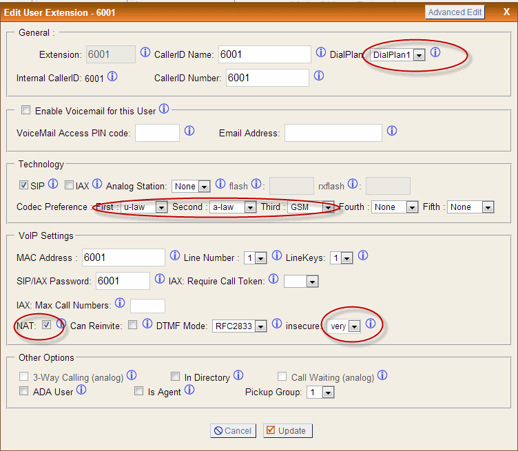

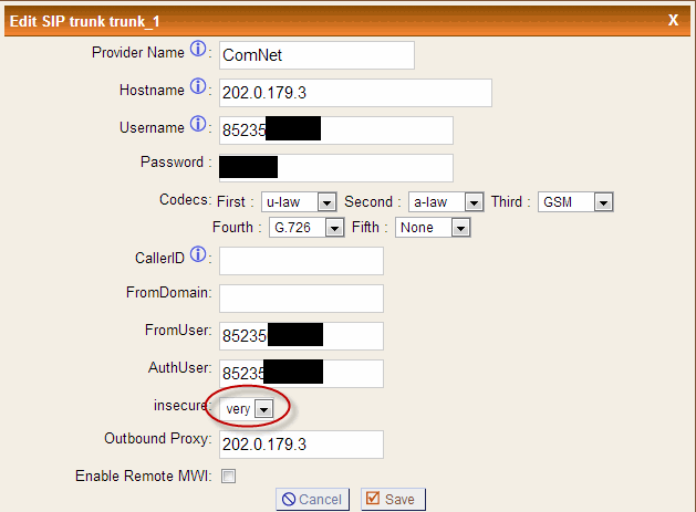

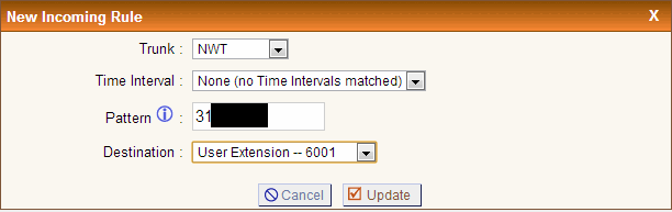

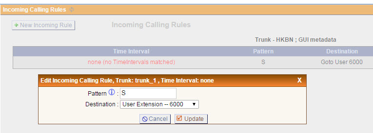

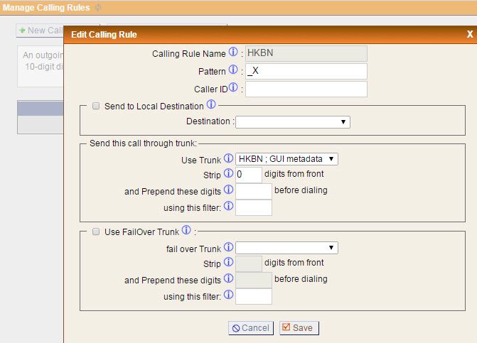

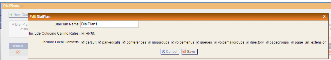

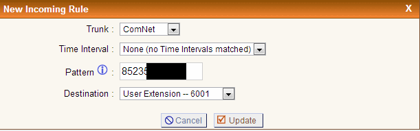

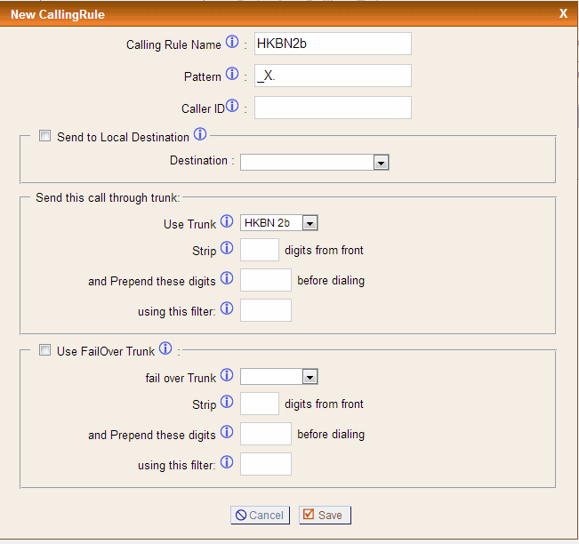

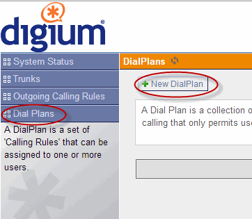

1. Create the NWT VoIP Trunk
and then re-edit again to add the follwing settings:
2. Create the outgoing rule for NWT Trunk
3. Create the dialplan to include the NWT VoIP Trunk
4. Create a user to use the dialplan
5. Inbound call settings
6. Other settings for outbound call (if not set, callee will not able to receive the call)
7. Apply changes
8. Minimum 300 seconds

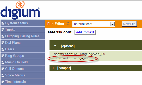

  1. handle_response_register: Got 423 Interval too brief for service 333445566@ngn2.nwtbb.com, minimum is 300 seconds
Using the File Editor (Advanced mode) to add the switch "defaultexpirey=300" to the users.conf under the NWT trunk. For details, pleas take a look the following scripts:

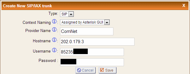

Please note the soft switch employed in ComNet Phone is a Huawei SoftSwitch "HuaweiSoftX3000"

1. Go to the left-side menu, select Options and then followed by choosing the Show Advanced Options. Click the SIP Settings and tick the checkbox of "Pedantic", as shown in the following figure (without the tick at "Pedantic" check box, you are not able to get the registration worked)
2. Create a VoIP SIP Trunk
And then re-edit again to add more itemss
3. Create a dialling prefix
Edit dialplan to add outbound SIP Trunk "NWT NetTalk"
Inbound settings
Edit asterisk.conf and then add the term "internal_timing=yes"
圖片附件: 1091.gif (2013-11-8 00:43, 17.93 KB) / 下載次數 2357

作者: 角色    時間: 2013-11-8 21:57
本帖最後由 角色 於 2013-11-8 22:00 編輯

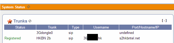

Asterisk-GUI Settings for HKBN 2b Trunk
1. Create VoIP Trunk
Further modify the trunk by editing.

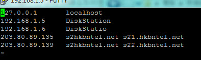

Using an editor like vi to add the following line at the end of /etc/hosts
203.80.89.135   s2hkbntel.net s21.hkbntel.net
2. Create dial prefix
3. Add the default dial plan
4. Add the incoming settings:
5. Reboot the system
6. Check the system status
圖片附件: 1093a.gif (2013-11-8 21:54, 9.74 KB) / 下載次數 2351

作者: 角色    時間: 2014-1-1 22:51
NWT NetTalk 注册和打出问题
Registration =No or No Authentication
终于周处问题所在:
就是在sip.conf,trunk definition,要加 qualify=no
就是在
  1. [nwt-nettalk]
  2. username=31xxxyyy
  3. type=friend
  4. secret=Password
  5. qualify=no
  6. port=5060
  7. insecure = port,invite
  8. host=ngn2.nwtbb.com
  9. fromusername=31xxxyyy
  10. fromuser=31xxxyyy
  11. fromdomain=home1.com
  12. dtmfmode = rfc2833
  13. canreinvite = no
  14. defaultexpirey=300
  15. context = from-nwt-nettalk

作者: kinuschan    時間: 2014-1-22 07:44
回復 44# 角色
關於2B的設定,我設完後, 有以下的ERROR LOG :
  1. NOTICE[8498] chan_sip.c: -- Registration for '3619xxxxhk@s2hkbntel.net' timed out, trying again (attempt #73)
而我的設定如下:
  1. host=s2hkbntel.net
  2. username=3619xxxxhk
  3. secret=xxxxxxxxxx
  4. trunkname=HKBN_2B
  5. port=5060
  6. context=DID_trunk_5
  7. hasexten=no
  8. hasiax=no
  9. hassip=yes
  10. registeriax=no
  11. registersip=yes
  12. trunkstyle=voip
  13. fromuser=3619xxxxhk
  14. insecure=port,invite
  15. fromdomain=s2hkbntel.net
  16. disallow=all
  17. allow=ulaw,alaw,gsm,g726
請問點解接唔到通呢?
另外, 我也設了
/etc/hosts

203.80.89.139   s2hkbntel.net s22.hkbntel.net
作者: 角色    時間: 2014-1-22 23:11
As far as I know that there are two set of hostnames for two groups of HKBN 2b lines. If one of them does not work, we can switch to another one for testing. In general, it should solve the issue.
作者: kinuschan    時間: 2014-1-23 11:34
回復 56# 電腦超人
在hosts 加左以下兩句 :
但仲未接通. error 係以下:
  1. [Jan 23 11:19:47] NOTICE[8498] chan_sip.c:    -- Registration for '3619XXXXhk@s2hkbntel.net' timed out, trying again (Attempt #6)
  2. [Jan 23 11:20:07] NOTICE[8498] chan_sip.c:    -- Registration for '3619XXXXhk@s2hkbntel.net' timed out, trying again (Attempt #7)
請問師兄有冇其他建議呢?

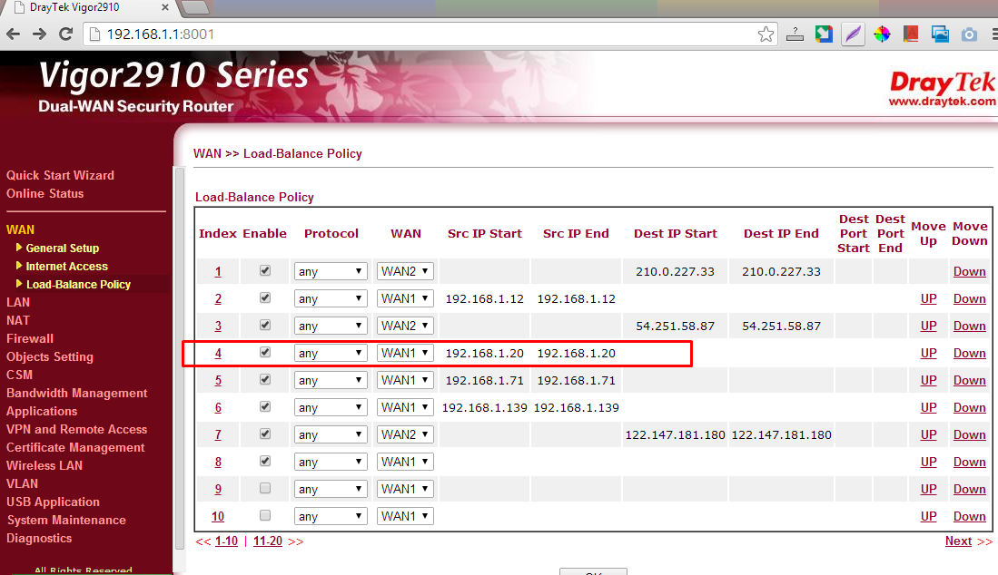

你是 Single Wan Or dual Wan?
作者: kinuschan    時間: 2014-1-23 13:32
本帖最後由 kinuschan 於 2014-1-23 13:39 編輯
回復 59# ckleea
系DUAL WAN
那應該怎樣做呢?
我都設左把所有資料經一個WAN 走.
圖片附件: Screenshot_6.png (2014-1-23 13:38, 193.53 KB) / 下載次數 2073
http://www.telecom-cafe.com/forum/attachment.php?aid=3161&k=4bf9135e442352e86c947e6f41a825ae&t=1790782632&sid=YEi4XA
作者: ckleea    時間: 2014-1-23 13:58
理論上你的設定是正確,但我都冇法解決。
你看一看你第八條 Policy會否影響。
作者: kinuschan    時間: 2014-1-23 14:19
回復 61# ckleea
謝謝你. 不過試過改左POLICY 都唔成功.
要再睇睇有冇其他方法.
我在同一個LAN , 用手機用2B APP 登入係成功. 問題係唔明白點解掛唔到上去果ASTERISK 到.
作者: ckleea    時間: 2014-1-23 14:28

作者: bubblestar    時間: 2014-1-23 16:54
回復 58# kinuschan
你這個情況,我遇過了很多次,我的ATCOM IP01、Raspberry PI 同樣裝了 2b,註冊上沒有問題,唯獨在Asterisk on CentOS 上註冊不了,最後發覺把Primary DNS 及 Secondary DNS 分別改為 8.8.8.8 及 router 的 IP 192.168.X.X 便解決了。 如果只用 8.8.8.8 及 8.8.4.4 會有時註冊到,但有時就沒法註冊的。

上面的HKBN 2b settings漏了inbound registration。
