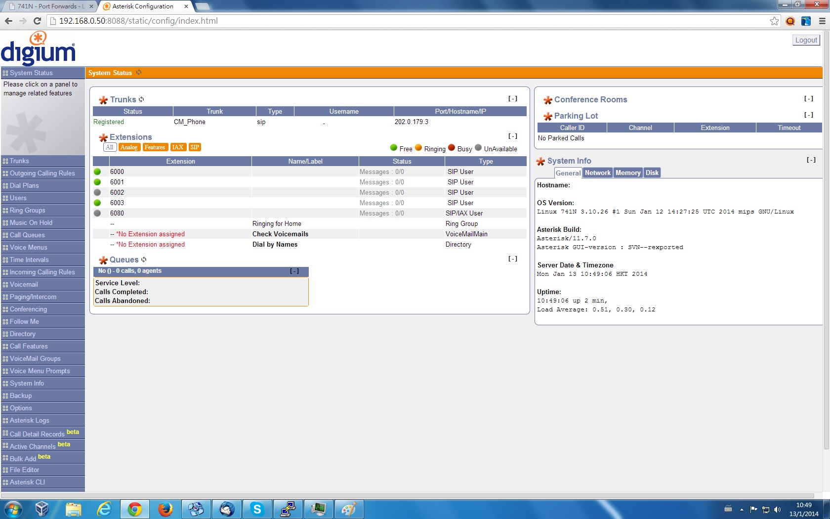

首先你需要一台能刷openwrt 的路由器,而路由器的flash最小也得8M,否則不夠空間刷asterisk(套件需要3.x MB的空間,安裝前請確認有足夠的空間)
首先,ssh入router,打以下指令:
opkg update  (取得最新的軟件清單)
opkg install asterisk11-gui (也可以是asterisk18-gui)
等待安裝完後,動啟路由器就可以入到asterisk-gui界面了
以下是我用tplink 741n 改8mb flash, 64mb ram後運行asterisk gui的截圖,有什麼不懂的地方可以在此貼發問
圖片附件: asterisk.jpg (2014-1-13 11:06, 304.65 KB) / 下載次數 1495

作者: 321    時間: 2014-1-13 11:14
其實32mb ram已經足夠運行openwrt + asterisk with GUI, 開機只用了25MB ram.
這應該是最便宜的asterisk方案了

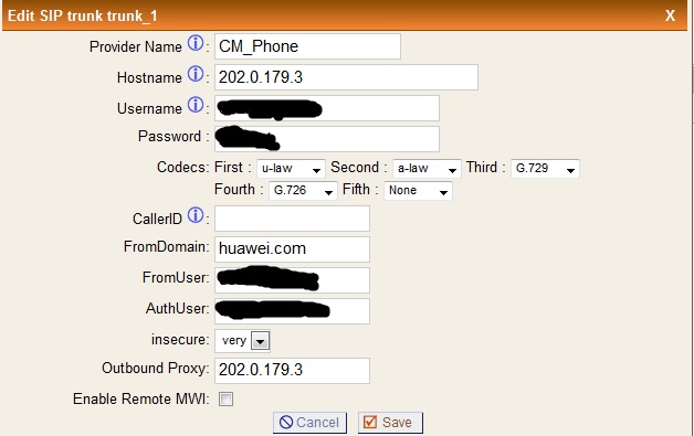

作者: 321    時間: 2014-1-13 11:17
附上sip trunk參數
圖片附件: cmphone.jpg (2014-1-13 11:17, 51.62 KB) / 下載次數 1476
http://www.telecom-cafe.com/forum/attachment.php?aid=3148&k=645047029616a8c1ffc9e2887af38bd6&t=1790648854&sid=ezz8qL
作者: 321    時間: 2014-1-13 17:37
現在不能打出了,我打91000出去,會忙音. 下面的log請大家幫忙分柝一下問題出在哪裡
== Using SIP RTP CoS mark 5
    -- Executing [91000@DLPN_DialPlan1:1] Macro("SIP/6080-0000000c", "trunkdial-
failover-0.3,SIP/trunk_1/1000,,trunk_1,") in new stack
    -- Executing [s@macro-trunkdial-failover-0.3:1] GotoIf("SIP/6080-0000000c", "0?1
-fmsetcid,1") in new stack
    -- Executing [s@macro-trunkdial-failover-0.3:2] GotoIf("SIP/6080-0000000c", "0?1
-setgbobname,1") in new stack
    -- Executing [s@macro-trunkdial-failover-0.3:3] Set("SIP/6080-0000000c",
"CALLERID(num)=") in new stack
    -- Executing [s@macro-trunkdial-failover-0.3:4] Set("SIP/6080-0000000c",
"CALLERID(all)=") in new stack
    -- Executing [s@macro-trunkdial-failover-0.3:5] GotoIf("SIP/6080-0000000c", "0?1
-dial,1") in new stack
    -- Executing [s@macro-trunkdial-failover-0.3:6] Set("SIP/6080-0000000c",
    -- Executing [s@macro-trunkdial-failover-0.3:7] Set("SIP/6080-0000000c",
    -- Executing [s@macro-trunkdial-failover-0.3:8] Goto("SIP/6080-0000000c", "1-
    -- Goto (macro-trunkdial-failover-0.3,1-dial,1)
    -- Executing [1-dial@macro-trunkdial-failover-0.3:1] Dial("SIP/6080-0000000c",
"SIP/trunk_1/1000") in new stack
    -- Called SIP/trunk_1/1000
    -- Got SIP response 503 "Service Unavailable" back from 202.0.179.3:5060
    -- SIP/trunk_1-0000000d is circuit-busy
  == Everyone is busy/congested at this time (1:0/1/0)
    -- Executing [1-dial@macro-trunkdial-failover-0.3:2] GotoIf("SIP/6080-0000000c",
"0 > 0 ?1-CONGESTION,1:1-out,1") in new stack
    -- Goto (macro-trunkdial-failover-0.3,1-out,1)
    -- Executing [1-out@macro-trunkdial-failover-0.3:1] Hangup("SIP/6080-0000000c",
"") in new stack
  == Spawn extension (macro-trunkdial-failover-0.3, 1-out, 1) exited non-zero on
'SIP/6080-0000000c' in macro 'trunkdial-failover-0.3'
  == Spawn extension (DLPN_DialPlan1, 91000, 1) exited non-zero on 'SIP/6080-
0000000c'
OpenWrt*CLI>
作者: 321    時間: 2014-1-14 19:10
似乎這裡非常冷清
作者: 角色    時間: 2014-1-14 20:05
没有看到嘛!应该要很多settings才可以拨出,详细看其他有关帖子。
作者: 321    時間: 2014-1-15 00:36
角色 發表於 2014-1-14 20:05
已經按照了你的帖子去做,還是無法打出打入。
相同的設置下,centos下編譯的asterisk11 with gui可以完全正常打出打入。
難道openwrt的asterisk11還需要按照其他插件才能打出?
另外我openwrt asterisk11可以trunk到我舊的asterisk server with cmphone,並且可以打出電話
作者: 321    時間: 2014-1-15 08:46
本帖最後由 321 於 2014-1-16 11:41 編輯
Inernal_timming=yes
Quality=no,也試過,依然無法打入打出
裝上了asterisk11-res-timing-pthread這個軟件包後,就可以打出打入了.
作者: 321    時間: 2014-1-15 11:19
    -- Executing [91000@DLPN_DialPlan1:1] Macro("SIP/6000-00000000", "trunkdial-failover-0.3,SIP/trunk_1/1000,,trunk_1,") in new stack
    -- Executing [s@macro-trunkdial-failover-0.3:1] GotoIf("SIP/6000-00000000", "0?1-fmsetcid,1") in new stack
    -- Executing [s@macro-trunkdial-failover-0.3:2] GotoIf("SIP/6000-00000000", "0?1-setgbobname,1") in new stack
    -- Executing [s@macro-trunkdial-failover-0.3:3] Set("SIP/6000-00000000", "CALLERID(num)=") in new stack
    -- Executing [s@macro-trunkdial-failover-0.3:4] Set("SIP/6000-00000000", "CALLERID(all)=") in new stack
    -- Executing [s@macro-trunkdial-failover-0.3:5] GotoIf("SIP/6000-00000000", "0?1-dial,1") in new stack
    -- Executing [s@macro-trunkdial-failover-0.3:6] Set("SIP/6000-00000000", "CALLERID(all)=") in new stack
    -- Executing [s@macro-trunkdial-failover-0.3:7] Set("SIP/6000-00000000", "CALLERID(all)=") in new stack
    -- Executing [s@macro-trunkdial-failover-0.3:8] Goto("SIP/6000-00000000", "1-dial,1") in new stack
    -- Executing [1-dial@macro-trunkdial-failover-0.3:1] Dial("SIP/6000-00000000", "SIP/trunk_1/1000") in new stack
    -- SIP/trunk_1-00000001 is circuit-busy
    -- Executing [1-dial@macro-trunkdial-failover-0.3:2] GotoIf("SIP/6000-00000000", "0 > 0 ?1-CONGESTION,1:1-out,1") in new stack
    -- Executing [1-out@macro-trunkdial-failover-0.3:1] Hangup("SIP/6000-00000000", "") in new stack
  == Spawn extension (macro-trunkdial-failover-0.3, 1-out, 1) exited non-zero on 'SIP/6000-00000000' in macro 'trunkdial-failover-0.3'
  == Spawn extension (DLPN_DialPlan1, 91000, 1) exited non-zero on 'SIP/6000-00000000'
作者: 321    時間: 2014-1-15 11:21
其中
為什麼comnet phone會feedback busy?
作者: 321    時間: 2014-1-15 16:18
終於成功打入打出.我把所有asterisk11的package裝好了就能打出打入了
作者: 角色    時間: 2014-1-15 22:22
回復 11# 321
恭喜你。
作者: 321    時間: 2014-1-16 00:56
回復 12# 角色
謝謝你對我學習asterisk的幫助。
現在我的路由asterisk server已經取代了我用了兩年的asterisk PC server.
現在運作我十分滿意。
之前無法打出打入,是因為我沒有安裝 asterisk11-res-timing-pthread這個套件,並非是設定上的問題。
我稍後會重新整理,再把openwrt上安裝asterisk gui及設定cmphone出簡單的教程。
目前這裡好像還沒有兄弟在路由器上跑asterisk吧?希望有興趣的朋友可以一起討論一下這個話題
