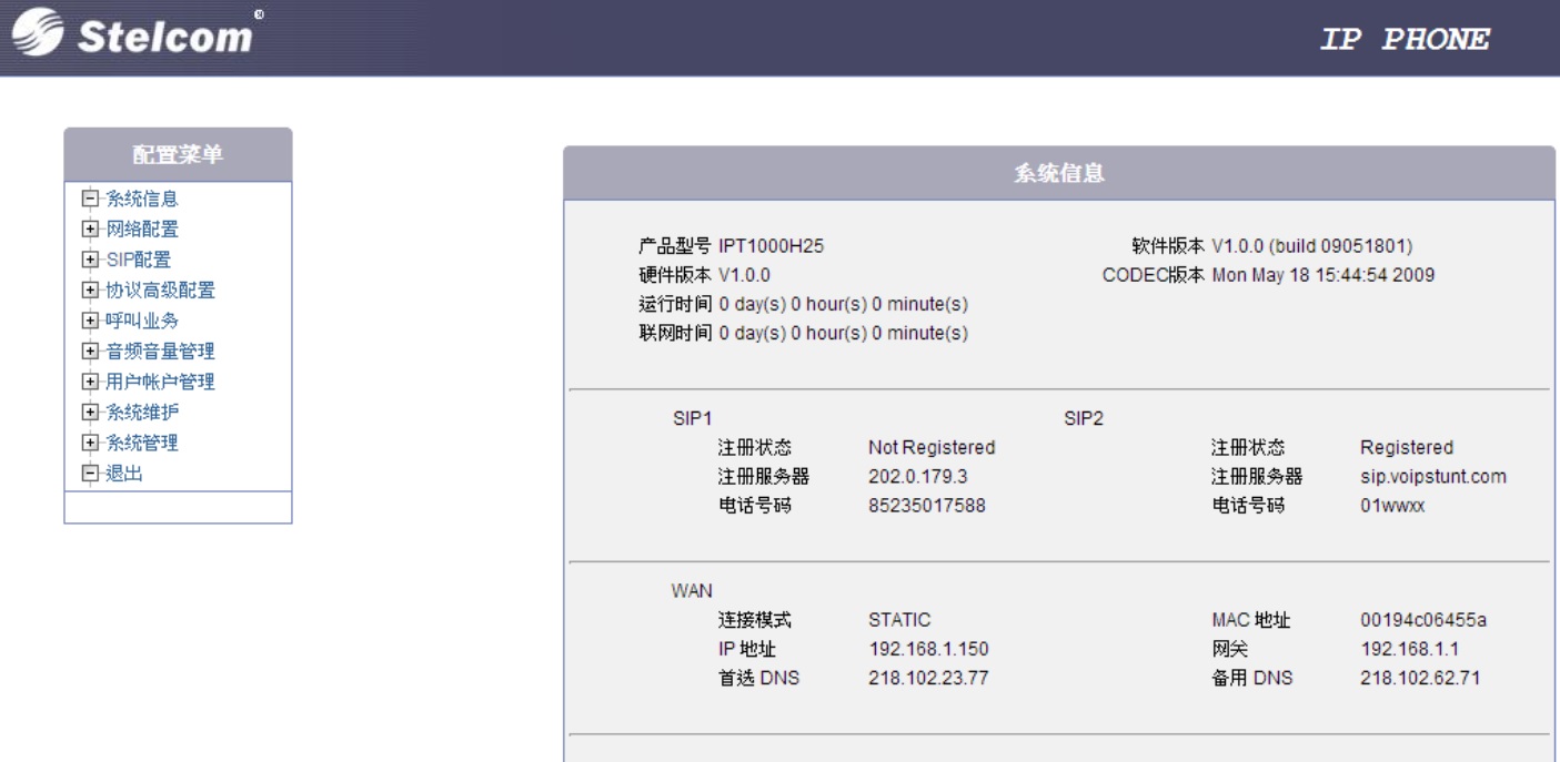

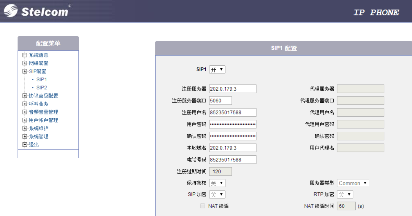

買了一部sip phone,可以註冊voipstunt,但comnet註冊唔到,是否"本地域名"一定要入名如sip.xxxx.com才能成功登記,或有其他細節未有設定。請高手告知,謝謝。

Q> 是否"本地域名"一定要入名如sip.xxxx.com才能成功登記
A> You can verify such indirectly by changing the 本地域名 configuration of SIP2 from sip.voipstunt.com to 77.72.169.129 and see if you can still register succesfully. If you can still register successfully, then it means your SIP phone can support both URL and IP address for the 本地域名 configuration.
作者: SuiYan    時間: 2014-5-14 23:08
你試下在 "本地域名" 202.0.179.3 後, 加 :5060  變成 202.0.179.3:5060  試1試
