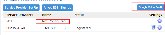

近日登录OBItalk更改一下GV帐号,但怎么试都改不了。
奇怪obitalk 无法更改或添加 google voice帐号了?
怎么回事啊?

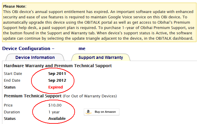

作者: Skypeus    時間: 2015-9-14 10:53
难道是这个吗? 要付费才能更改设置吗?
Please Note:
This OBi device's annual support entitlement has expired. An important software update with enhanced security and ease of use features is required to maintain Google Voice service on this OBi device. To automatically upgrade this device using the OBiTALK portal as well as get access to Obihai’s Premium Support help desk, a paid support plan is required. To purchase 1-year of Obihai Premium Support, use the button found in the Support and Warranty tab. When device's support status is Active, the software update can continue by selecting the update triangle adjacent to the device, in the OBiTALK dashboard.

作者: Skypeus    時間: 2016-3-9 17:42
自从上次在OBitalk网页上不小心把SP1的GV删除后,就再也添加不进去GV了,手动在OBI110里面怎么设置才能用GV呢?

作者: Skypeus    時間: 2016-3-11 10:03
回復 10# 角色
    最后,还是解决了这个问题。 谢谢角色的指导!
1.确保您的GV号码还能正常使用,号码没有被回收。
2.进入Obi110后,手动直接set GV。
3.返回Obitalk看SP1状态还是Not-Configured,其实是已经可以用GV打出电话了
(我被这个状态Not-Configured忽悠了好久,一直以为手动set的不行。)
4.现在GV号码重返我的OBi110了,:D
作者: ttmuskie    時間: 2016-3-11 17:23
1.确保您的GV号码还能正常使用,号码 ...
Skypeus 發表於 2016-3-11 10:03
So, don't have to pay $10 annual fee?
