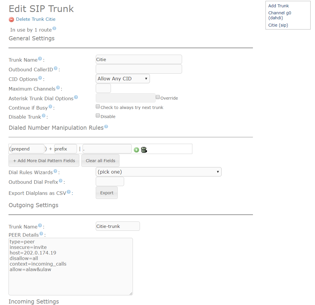

Hi,
We've setup a Elastix and try to connect to CITIC SIP trunk. CITIC told us that they don't have any Elastix/Asterisk connection information can provided for us.
They do allow our Elastix IP to access to their gateway and give us a phone number say 88888888. ( No user name and password provided )
We have create a SIP trunk in Elastix but only able to make a outgoing call - Incoming call doesn't work.
The config for PEER Details
type=peer
insecure=invite
host=202.0.174.19
disallow=all
context=incoming_calls
allow=alaw&ulaw
No idea how to setup USER Details.
Any help/suggestion is much appreciated.
Thank you.

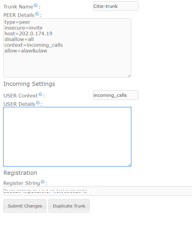

作者: taihung    時間: 2018-7-6 14:42
Thanks for your prompt response but it still doesn't work.

作者: 角色    時間: 2018-7-6 15:19
1. Please check whether it can be registered or not.
2. When making incoming calls, please check the log to see what happens. (In general, you have to input something like /usr/sbin/asterisk -rvvv, where the path may be incorrect, please check yours).
