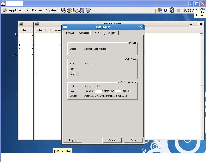

Success has been made to use OBiApps in Centos with Wine support.
My softphone can connect and register the OBiApps proxy from my remote Windows PC.
Dial in and out are ok.
But I do not have a native softclient in linux to test out.
Also as reported somewhere, I am not able to make asterisk to register
It either says 404 not found, do not implement 'Register' or time out
successful registration by asterisk to OBiApps (all within my linux server) made
screenshot.24-03-2011 06.32.50.jpg (55.9 KB)

我估計已經解決
1. you need a linux server
2. install wine support
3. 2 network card or virtual network card.
4. install OBiApps and run by wine
5. change your default OBiApps sip port to  other
6. start OBiApps to register
7. in sip.conf [General]
register => 29xxxxxxxx@127.0.0.1/29xxxxxxxx (/29xxxxxxxx is very important)
8 add a context for dial out, using a different network port. Otherwise you will receive loopback detect
9. a context in extension to dial out
Enjoy.

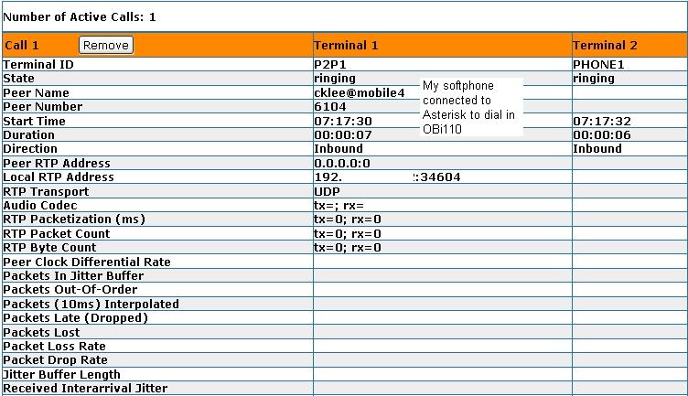

Result as shown
screenshot.24-03-2011 07.17.53.jpg (80.8 KB)
TOP
I tried further. I can call in via my OBiOn -> asterisk -> what ever thing you want.
TOP
Basically it works very well, but I need fine tuning and redesign of the dialplan.
TOP

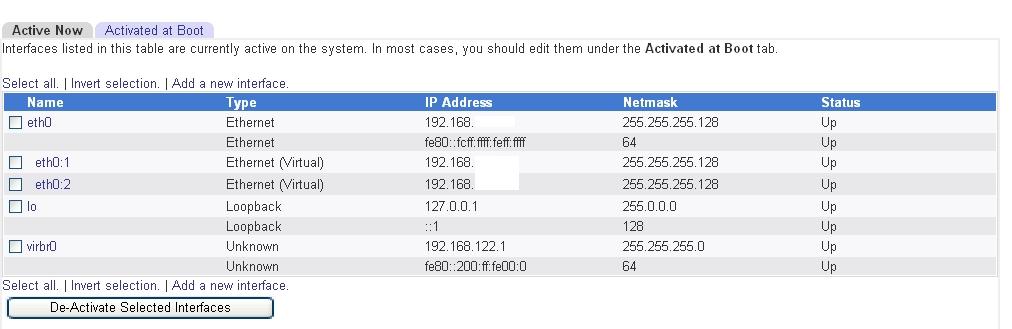

4. Next is use webmin to enable/add virtural network interface (this is very important)
Alternatively, if you an extra network card, you may bind the OBiApps incoming to this address.

Please note that a virtual network ip at 192.168.xxx.yyy is important here to avoid loopback detected. Otherwise you can't dial out.
